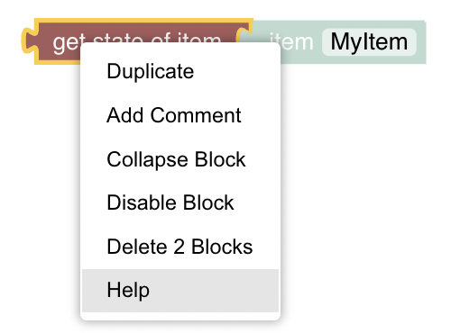

A special mention should go towards the Help entry in a block context menu right click on any block that links to a resource that is usually very helpful to understand the context of that particular block. To retrieve the particular help for a block right click on a block to open the context menu and click on the help-entry:
There is also a help-button available in each section that links to the documentation of the whole section.

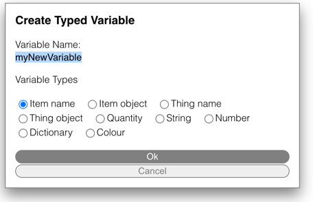

Create a typed variable by clicking on the following button:
This will open up the following dialog:
Hint: Always choose the type of the variable first because it is not possible to change the type afterwards!
- Enter the name of the variable: it is recommended to use a concatenation of the variable name plus the type like powerItemName as it is hard to know later on what type the variable has.
- Don't forget to select the right type (here "Item name") before clicking ok because it cannot be changed later.
- Click ok to create the variable
You will notice that this typed variable can only be used in inputs where normally an Item (name) block would have been allowed.
