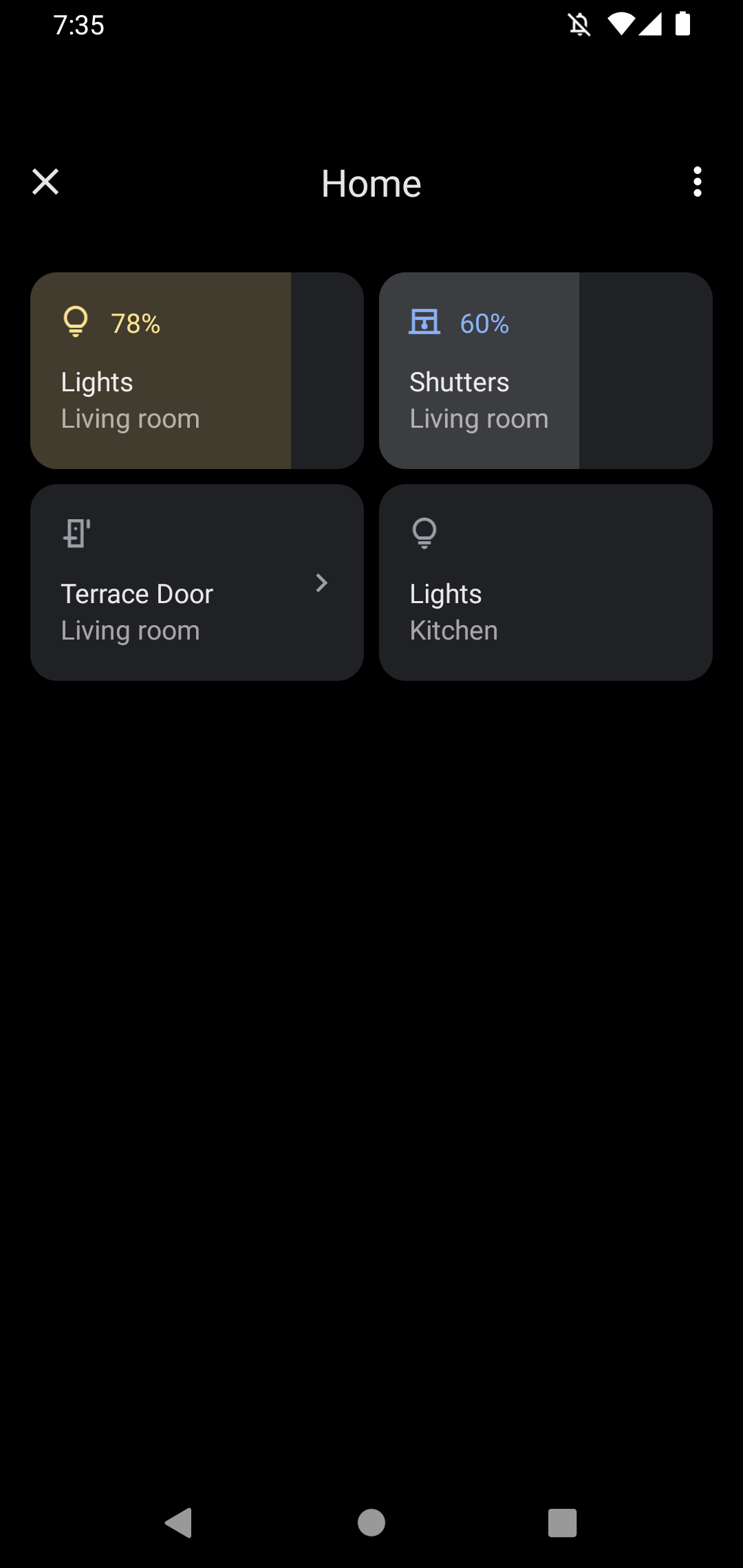

# Device Controls
openHAB supports the device controls introduced in Android 11: https://developer.android.com/develop/ui/views/device-control (opens new window) When using a semantic model (opens new window) the location and/or equipment name can be shown in the tiles. The icon in the tiles is based on the semantic class of the Item.
You can configure the page that is opened when you long-press a tile.
Create an "Android App: Device Controls" metadata on an Item with a link without the host to a Sitemap (e.g. /basicui/app?w=0202&sitemap=demo) or MainUI (e.g. /locations).
