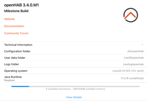

# Top Section
  • Version: shows the currently installed version of openHAB
  • Links to the official openHAB Website, the openHAB Documentation and the Community Forum
# Technical Information
This section is collapsed by default and can be opened by clicking on it which then reveals the
  • Configuration folder on the server
  • User data folder on the server
  • Logs folder on the server
  • Operating System openHAB is running on
  • Java Runtime openHAB is running on
  • Number of processors and memory
Clicking on View Details opens up a popup window that contains very detailed information like
  • Runtime information
  • Locale (language)
  • System information including memory information
  • A list of all installed bindings
  • Client information including device information, client settings (see also the below section), screen information, theme, user agent information.
The content can be easily copied with the copy button on the top to provide it as additional information when asking questions in the community.

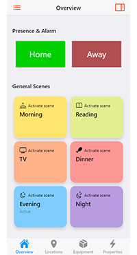

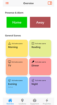

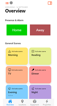

  • Simple navigation bar on home page: When switching it on, it means the navigation bar will look the same even whether you're at the top of the page or not - you won't have the alternate look with the date. The first image depicts the normal setting (off), the second image shows it switched off
  • Standard home page background color: This only relates to the light color scheme. The background color will be the same as the regular pages you can show from e.g. the sidebar, which is a kind of gray instead of white. The first image depicts the normal white setting (off), the second image shows it switched off with the gray setting.

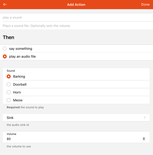

You can also configure webaudio as sink when creating rules in the UI:

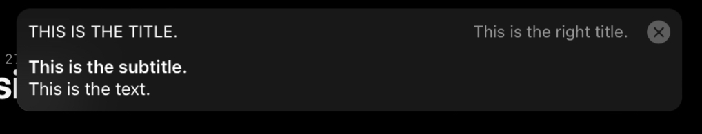

  • notification:$text:$title:$subtitle:$titleRight:$closeTimeout: Display a notification inside the UI: The $text parameter is mandatory, all other parameters are optional. $closeTimeout is in milliseconds and defaults to 5000, which means by default a notification will be closed after 5 seconds. To leave out a parameter, leave a colon space empty, e.g. notification:$text:$title:::$closeTimeout.
    For example, send notification:This is the text.:This is the title.:This is the subtitle.:This is the right title. to the UI command Item to display the following notification:
    notification
