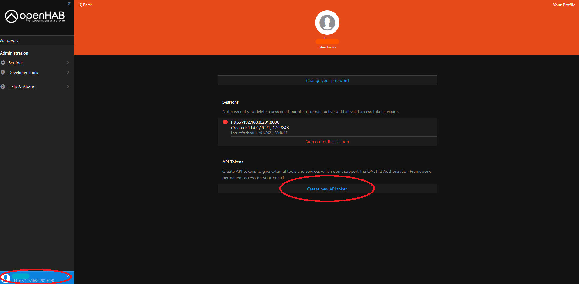

Sign in to openHAB with your administrator username and password, by clicking on the sign-in button (bottem left).
After signing in, click again on the profile button to access your profile page. Click on Create new API token.

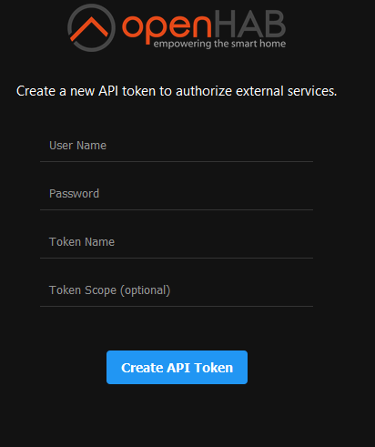

Use your admin username and password and fill in the token name (e.g. the service you want to gain access for) and a Token Scope.
Create token

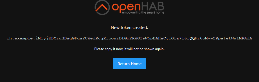

Now the token is created. Copy the complete token.
Token
