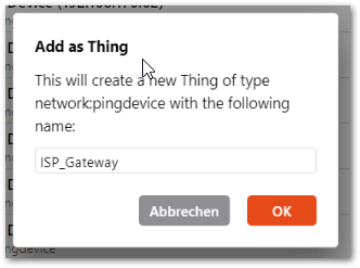

Step 1. Add new Thing (name: ISP_Gateway) from UI:
Add_Thing_UI

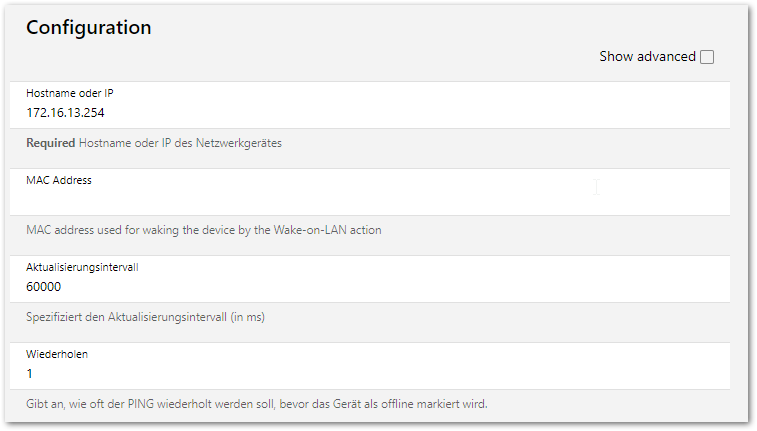

Step 3. Using UI ➡️ Settings ➡️ Things, edit the new ISP_Gateway Thing and modify the following parameters:
  • Location (from unset to MyHome)
  • Retry (from 1 to 3)
  • Timeout (from 5000 to 10000)
and save:
Edit_Thing_UI
