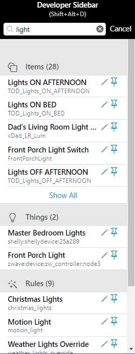

Imagine you need to find all usages of an Item in rules or pages. You could open all your rules and pages to check them, or just use the developer sidebar search. Enter your Item name, and you will see in which rules, scenes, scripts and pages that Item is used.
For more information about the search and which entities are searchable, please refer to the Developer Sidebar docs.

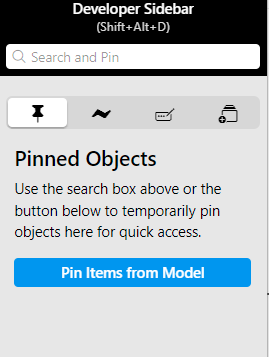

# Pinned Objects
Let's say you are working on your lighting automations which involves Things, Items, and Rules. Instead of keeping a dozen browser tabs open and flipping between them you can pin these objects to the sidebar.
Enter a search term in the search filed at the top to search within Items, Things, Rules, Scripts, Scenes and Pages. The search term can be part of an object's name, ID, label, etc.
search
Once you find an object that you want to pin, click the push-pin icon to keep it in the list. Once you've pinned all the objects you want, click the x icon in the search bar.

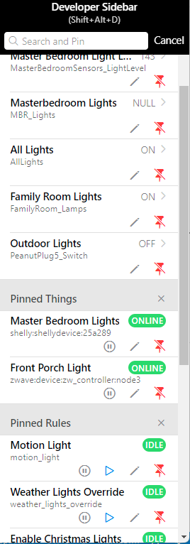

pinned
Once pinned each entry will show some relevant controls and status. All object will have a pencil icon which will take you straight to that object's page where it can be edited. Clicking the red push-pin icon will unpin the object from the sidebar.
To the right of Items will be their current state and often clicking on that state will bring up that Item's default widget where it can be controlled.
item control
Things will show the current status of the Thing to the right and additionally have a pause icon that can be used to disable the Thing.
thing
Rules show the rule's current status to the right. This is one way to monitor when a rule is running as the current status will change to show the rule is running. However, if the rule runs very fast it might flash too quickly to see, so there are other ways to monitor that (see below).
In addition to the enable/disable control, rules also have a play icon where the rule can be manually triggered.
Once everything you are currently working on is pinned in one place, developing capabilities becomes much easier because everything you need is right there and you can get to everything you need to with one click. Objects will remain pinned until the sidebar is closed, even if you click to other tabs in the sidebar or navigate to another page in MainUI.

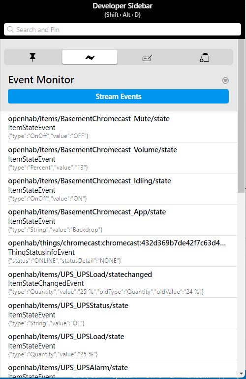

# Event Monitor
The next tab is the Event Monitor. This tab provides a filterable raw stream of all the events happening in openHAB. Believe it or not, what you see in events.log is a greatly reduced set of events.
event stream
Item events (update, changed, received command), Thing events (e.g. change in status), and rule events will appear in this stream. But on a typical system a lot of events will be happening all the time. Often one will want to filter. Clicking on the filter icon lets you enter a comma separated list of events that should be streamed. The list is OR meaning is any one matches the event will be shown. For example, entering *Hum* would only show those events that include "Hum" in the names.
This tab is a great tool to use when debugging a problem and developing rules and for many is more convenient than monitoring the logs in another tab.

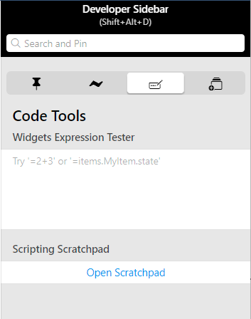

# Code Tools
The next tab presents a couple of tools to aid in coding: expression tester and scratchpad.
code tools
# Expression Tester
This tool is useful when developing custom widgets. Once can enter and see the results from expressions used to make widgets more dynamic and it is a great place to gradually build up a complicated expression, testing it each step of the way.
# Scratchpad
Clicking on this will open up a Script (rule with a single Script Action, no triggers or conditions) named "-Scratchpad-". This is intended to be a free form place to put in and manually execute some arbitrary and temporary rules code to test out how to do something or cause a complex set of behaviors to run. For this reason it's great for testing and debug.

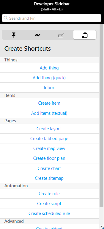

# Create Shortcuts
Finally, when developing a new capability a number of new objects will need to be created, such as adding a new Thing, creating some Items linked to that Thing, a rule or two and a custom widget or two. This fourth tab has quick links to create any sort of Object that can be created in OH saving you from needing to click through the Settings menu multiple times to create different but related objects.
