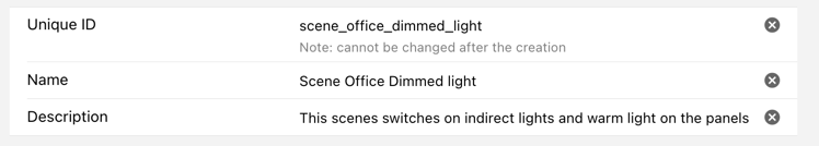

# Metadata
Each rule has four pieces of metadata.
Metadata Purpose Notes
Unique ID Uniquely identifies the rule Must be completely different from all other rule's UIDs, initialized with a random value but it is strongly recommended entering your own UID
Name "title" of the rule This will be the name under which the rule is shown in MainUI and is the primary field used for search and sorting
Description Describes what the rule does Do not skip, provide information about what the rule does and what it does it to; leave breadcrumbs you can use later to associated rules with Items and Channels

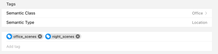

Tags Arbitrary tags Another place to leave breadcrumbs or to group rules together. Note the Script and Schedule tags have a special meaning (see previous page), and although Semantic tags are available, rules are not yet integrated into the Semantic Model.
scenes UI rule heading scenes UI rule heading tags

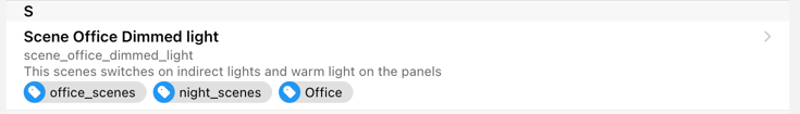

Here is how this rule appears in the list of rules (note the use a couple of tags):
scenes rule list entry

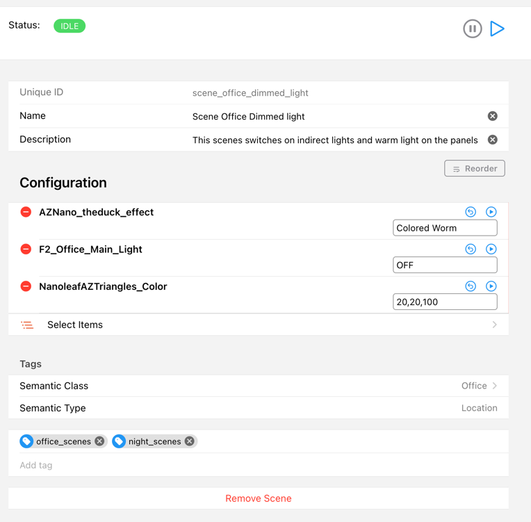

Finally, we want this rule to send some commands our items which is very convenient to configure in this editor. First, it is recommended you put all of your items in to the state that you want to store as scene.
After your scene of all the devices in your room (or house) has been set up, you assign these in the following section:
empty scene configuration
Choose the item either by clicking on item tree lookup to select it via the semantic model or on item list lookup via an item list. Note that you can select multiple items at the same time.
The item will then appear in the list together with the current state shown next to it. This state will later be sent when the rule is executed.
scene-entry1
In the above case the effect "Colored Worm" would be sent to the light panels. If you are not happy with that state either overwrite it manually or set the item to the state you want and the press the arrow to refresh to the current state:
scene-item-refresh
The play-button allows you to test the item state value that is currently chosen.
Add as many items until you end up with the scene that you wish to create:
complete-scene
You can reorder the items via the scene-reorder button. This also defines the sequence within which the commands are sent to the device's items.
Similarly to all other rules the play button scene-pause-and-play allows you to run the rule and test it out that way and the pause button allows you to halt the rule in case you want to prevent it to be executed. Saving can be done via Cmd/Ctrl-S and will automatically be done in case you press the play button.

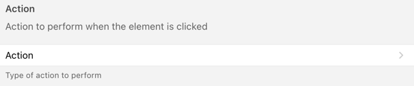

Create a label card on a page, give it a title and then open up the configuration dialog.

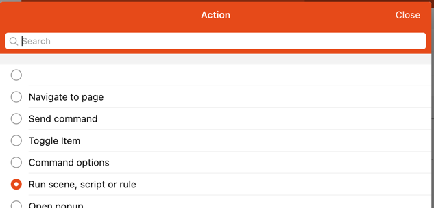

Choose the type of action to perform
action-type
then select "Run scene, script or rule"
choose-action

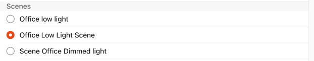

then click on "Scene, Script or Rule to run" and select from your list of scenes:
scenes-list
When you now click on that label card, the scene rule will be triggered and all of your item states will be sent as a command to these items.
