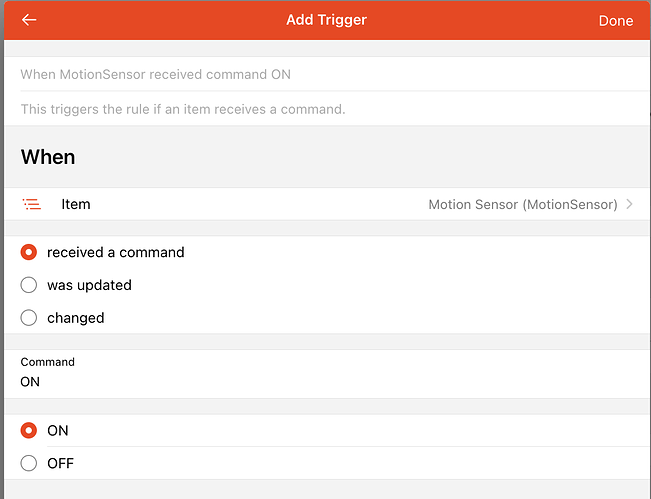

See the previous page for details on how to create the trigger you need. In this example we will use an ON command to the MotionSensor Item as the signal that there is motion. The motion sensor will timeout for 30 seconds before reporting motion again. There are three options to choose from which are explained very well here (opens new window). In simple terms "changed" means the rule only triggers if the state has changed for example from OFF to ON while "was updated" would even trigger the rule if "OFF" was set to an item state that was already OFF.
motion sensor received ON command

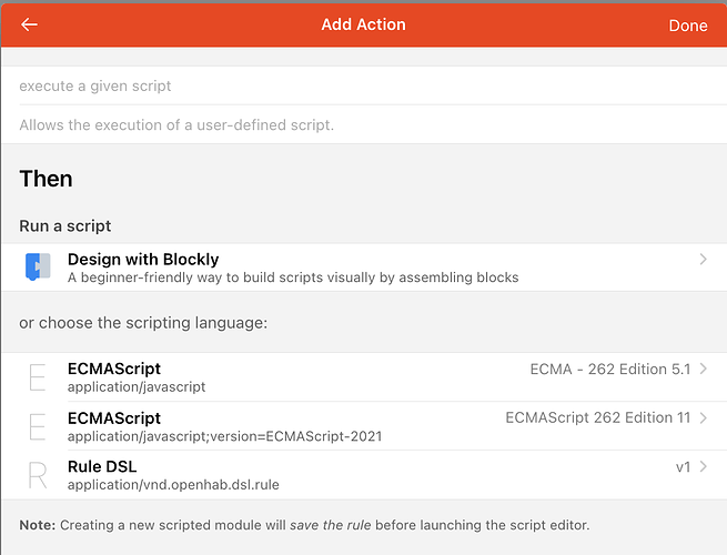

First create a new Action and choose Script Action and Design with Blockly.

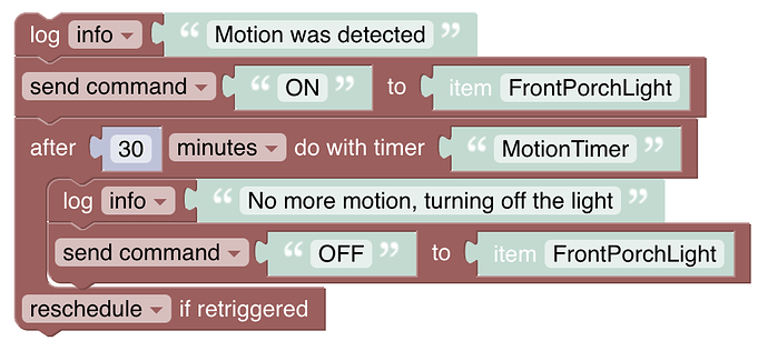

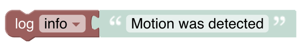

To start, we want to be able to see that this rule is running. So we will first add a log statement which you will find in the openHAB -> Logging & Output section. We will choose "info" for the level and type a message we want to see in openhab.log when this action is executed.
log motion

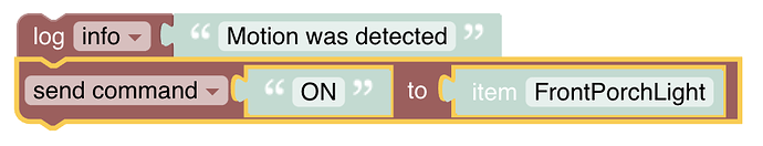

Next we want to command a light to turn ON. Under openHAB -> Items & Things you'll find a "send command" block. Drag that over and dock it under the log statement. We want to send ON to the Porch Light Item. If the light is already ON nothing will happen but, if your device behaves differently you might need to check to see if the light is already ON before sending the command.
command light ON

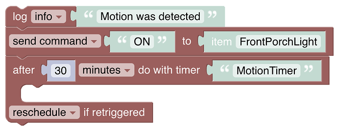

Next we want to set a timer. A timer is a way to schedule some code to run later on. The rule will continue and exist after the timer is created (i.e. it doesn't wait around) and the timer will execute in the background at the scheduled time.
In this case we want to wait thirty minutes. But we want to wait for thirty minutes after the last motion. This rule gets triggered every time motion is detected so we need to reschedule the timer every time motion is detected. A reschedule will tell the timer to run at a different time. Only when there has been thirty minutes of no motion will the blocks inside the Timer block be executed.
Under openHAB -> Timers & Delays drag the "after" block that includes "reschedule" at the bottom. We need to change the time to thirty minutes. Notice the little triangle next to "seconds". Clicking on that will bring up a list of options to choose from. Anywhere you see that triangle there are options (e.g. clicking on "info" for the log can change the logging level, clicking on "send command" lets you change to "post update").
Give the Timer a meaningful name. It's good to be in the habit of naming everything with a meaningful human readable name.
create timer
Now we need to add the block to run thirty minutes after the last motion was detected. We want to send an OFF command to the light. But, for testing and debugging we also want to log something out so add a log statement too.
log and command light OFF
Trigger the rule a few times and watch the logs to make sure you see the commands and logging events as expected. When testing, consider using a smaller timer time (e.g. three seconds) and change back to the desired time once you know it is working.

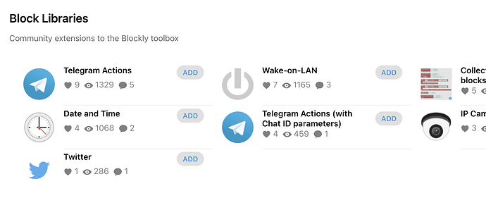

Navigate to Settings -> Automation and scroll down to "Block Libraries". Browse around to see if there are relevant libraries, in this case the "Date and Time" one looks most promising.
Blockly libraries
Click on it and add it and return to your rule. Now you will find that there is a dateTime entry under "Libraries". It looks like we will be using the "now" (the current time), "ZDT from item" (sunset time from the Astro binding), the ZDT with date" (hard coded time), and the "is" block to make the comparisons.

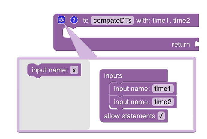

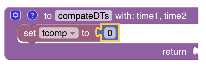

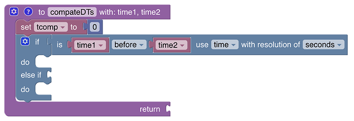

Under "Functions" drag the "to do something" block with the return statement. Next to "to" give it a meaningful name, we'll use "compareDTs". In this case, in order to do something useful we need to pass arguments to the function, two date times. To do this click the cog icon. This will bring up a way to add or remove features to any block that has the cog. In this case we want to add two "inputs". Drag them from the left to the right and give them names. You will now see the two inputs listed on the block.
define function with arguments

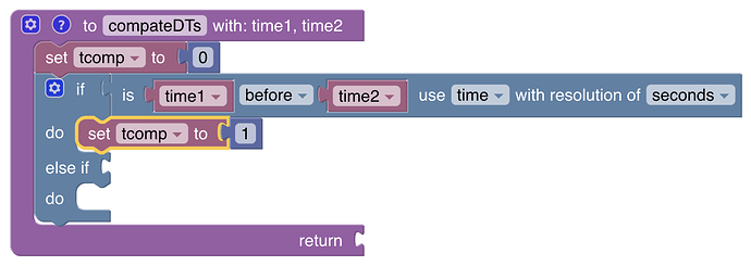

Now we want to compare the two passed in date times and return a value to indicate whether time1 is before or after time2. We will use 1 to indicate that time2 is after time1 and -1 to indicate that time2 is before time1. So first we need to create a variable so under Variables create a new variable called "tcomp" for "time compare". Then drag "set tcompt to" and dock it inside the function. Go to Math and drag the "123" block to plug into the "set" block. Change the value to "0".
initialize tcomp

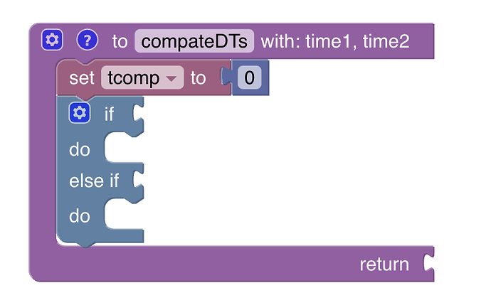

Now we will add an if statement to compare the times. We have two conditions to we will use the cog to add an "else if" to the if statement to. You can find the "if" block under "Logic".
if statement

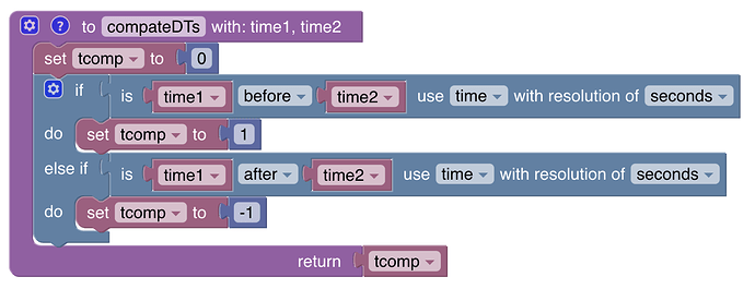

Now we will use the new "is" block from the library to see if time1 is before time2 and set tcomp to 1. Drag the 'is" block and plug it into the first if socket. Then under "Variables" drag the "time1" variable and plug it into the first slot after "is". Drag time2 to the the slot after "before". We only care about the time so change the config after "use" to "time" and keep the resolution at "seconds".
if condition

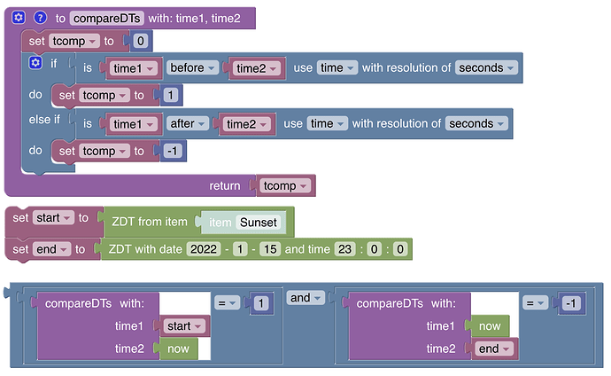

In this case we want to return 1 so right click on the "set tcomp" to block and choose "duplicate". This will create a copy of that set of blocks. Set the value to to 1. Drag the block next to the first "do".
tcomp == 1 if true

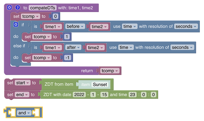

Duplicate the "is" and "set" blocks again to populate the "else if", this time setting to -1 when time1 is after time2.
Finally, drag the "tcomp" variable and plug it into the "return" socket.
function return

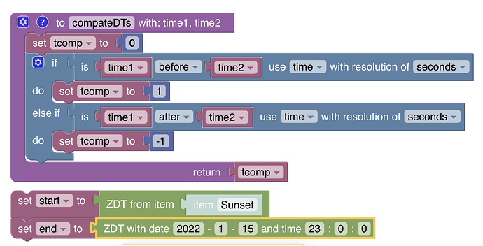

The hard work is now done. Now we just need to create a statement when now is between sunset and 23:00. To keep the blocks from getting too long and complicated, let's create some variables: "start" for the sunset time and "end" for 23:00. Set "start" to the "ZDT from item", selecting the Sunset Item. Set "end" to the ""ZDT with date" block. Set the time to "23:00:00" (we don't care what the date is set to).
Notice how the statements are not connected to our function. They represent a completely separate block of code. As previously mentioned, the flow of execution is top to bottom so it is a good idea to put functions above the code that calls them.
variables inintialized from item
Now all we need is the condition that evaluates to true or false when now is between start and end. From "Logic" drag the block that has "and" in it to just below our setting of the end variable. Normally a condition like this would dock to an if statement but we are going to use it on it's own.
add compound and condition as last statement
In the first slot, from the "Logic" category drag the block with "=".
add equals

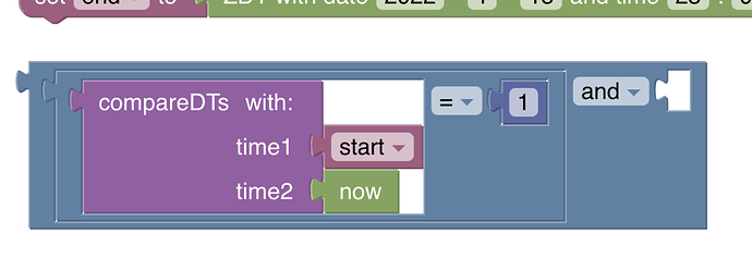

From "Functions" drag the block named "compareDTs" to the first open slot. This is our function. Plug in "start" from variables for "time1" and "now" from the dateTime library for "time2". From Math plug in "1" in the slot after the "=".
call function
Click under the "=" to select the whole comparison and duplicate it. Plug the duplicate into the slot after the "and" and change "time1" to "now" and "time2" to "end" and the number to "-1".
complete condition
