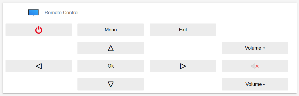

# Element Type 'Buttongrid'
Buttongrid [item=<itemname>] [label="<labelname>"] [icon=<iconref>] [staticIcon=<iconref>] [buttons="<Button definition>"]
A Buttongrid represents a grid of buttons and enables commands to be sent to an Item.
This is a typical element for simulating a remote control, for example.
  • item commands triggered by the buttons are sent to the item identified by this parameter. This parameter is only required if the buttons parameter is also used.
  • label if set, a header row will be displayed containing this label and the icon.
  • buttons defines the position of each button within the grid and the command associated with each button; provided as an array.
When buttons are defined by the buttons parameter, all buttons are linked to the same Item and a command can only be sent to that item when one button is clicked (and not when it is pressed and released); buttons never appear as selected, they do not display the current state of the linked Item. The buttons parameter is optional, using Button elements as children is now the best option because it provides more functionality, but this option is not yet supported by all sitemap UIs.
Buttons syntax:
buttons=[row_1:column_1:command_1="description_1", row_2:column_2:command_2="description_2"=<iconname>, ...]
The buttons can be defined in any order, their position in the grid is defined by a row index and a column index. The top left position is row index 1 and column index 1. The grid must not exceed 12 columns so the maximum allowed column index is 12 columns. It is not mandatory to define a button in all grid cells. The user interfaces will automatically determine the grid size so that all buttons are presented.
The content of each button can be text but also an icon; the icon will be used by default if provided.
Examples:
Buttongrid label="Remote Control" staticIcon=screen item=RemoteControl buttons=[1:1:POWER="Power"=switch-off , 1:2:MENU="Menu" , 1:3:EXIT="Exit" , 2:2:UP="Up"=f7:arrowtriangle_up , 4:2:DOWN="Down"=f7:arrowtriangle_down , 3:1:LEFT="Left"=f7:arrowtriangle_left , 3:3:RIGHT="Right"=f7:arrowtriangle_right , 3:2:OK="Ok" , 2:4:VOL_PLUS="Volume +" , 4:4:VOL_MINUS="Volume -" , 3:4:MUTE="Mute"=soundvolume_mute]
Presentation of the Buttongrid element in BasicUI

Buttongrid label="Remote Control" staticIcon=screen {
    Button row=1 column=1 item=RemoteControl label="Power" staticIcon=switch-off stateless click=POWER
    Button row=1 column=2 item=RemoteControl label="Menu" stateless click=MENU
    Button row=1 column=3 item=RemoteControl label="Exit" stateless click=EXIT
    Button row=2 column=2 item=RemoteControl label="Up" staticIcon=f7:arrowtriangle_up stateless click=UP
    Button row=4 column=2 item=RemoteControl label="Down" staticIcon=f7:arrowtriangle_down stateless click=DOWN
    Button row=3 column=1 item=RemoteControl label="Left" staticIcon=f7:arrowtriangle_left stateless click=LEFT
    Button row=3 column=3 item=RemoteControl label="Right" staticIcon=f7:arrowtriangle_right stateless click=RIGHT
    Button row=3 column=2 item=RemoteControl label="Ok" stateless click=OK
    Button row=2 column=4 item=RemoteControl label="Volume +" stateless click=VOL_PLUS
    Button row=4 column=4 item=RemoteControl label="Volume -" stateless click=VOL_MINUS
    Button row=3 column=4 item=RemoteControl label="Mute" staticIcon=soundvolume_mute stateless click=MUTE

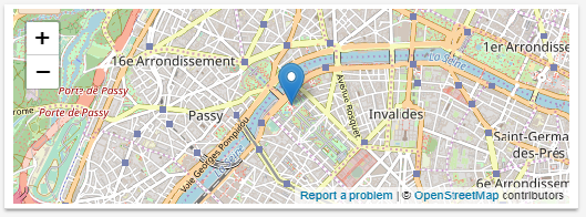

# Element Type 'Mapview'
Mapview [item=<itemname>] [label="<labelname>"] [icon=<iconref>] [staticIcon=<iconref>] [height=<heightvalue>]
Displays an OSM (opens new window) map based on a given Location Item.
  • height is the number of element rows to fill.
Example:
Mapview item=Demo_Location height=5
Presentation of the Mapview element in BasicUI
