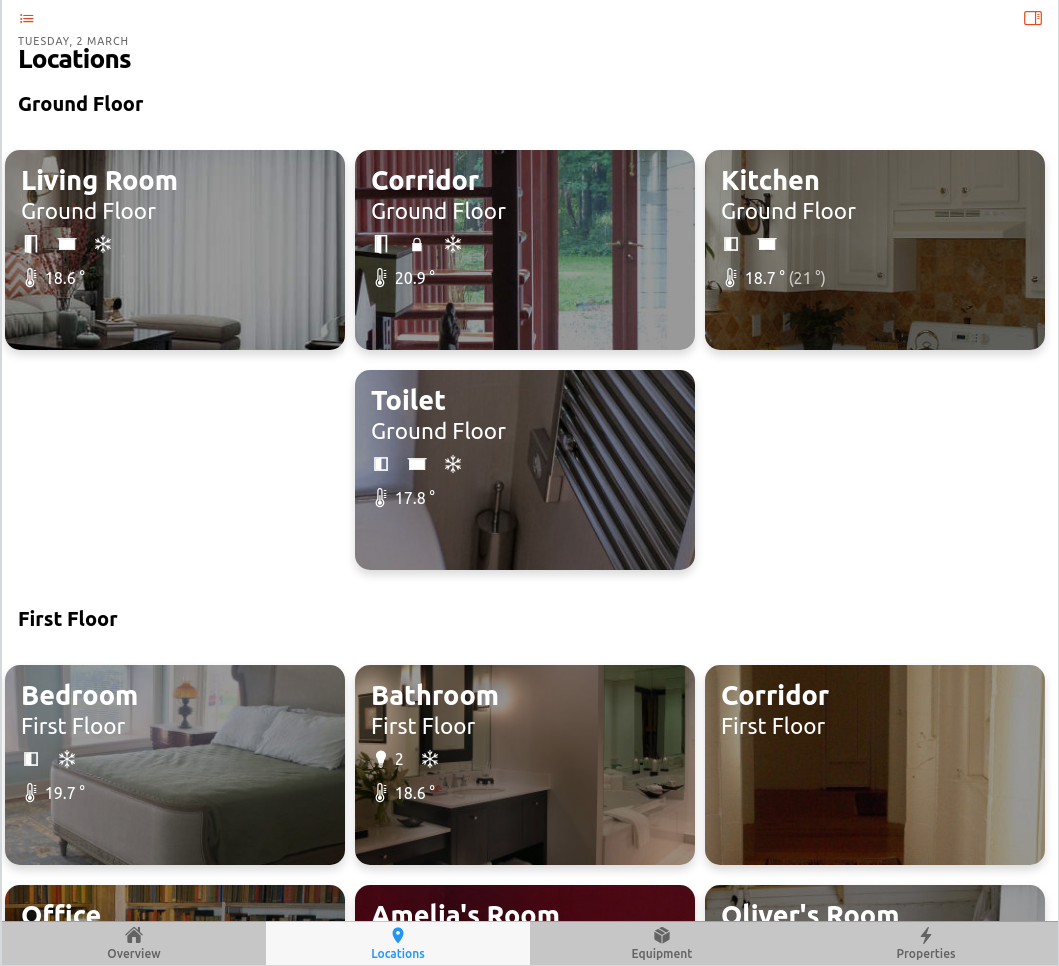

# Location Tab

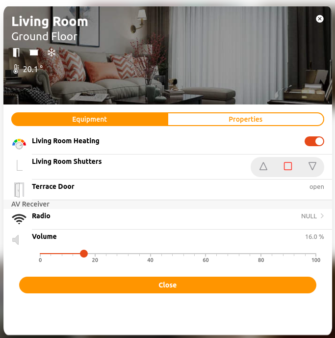

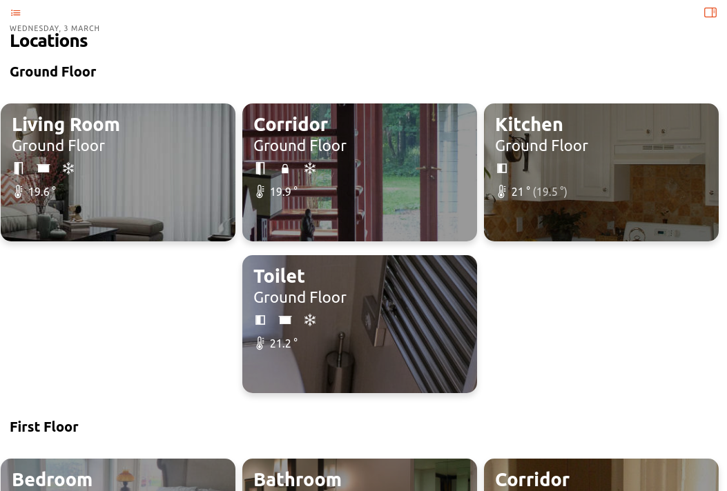

The semantic model is really starting to pay off here! All of the Locations from your model that have Equipment or Point Items directly in them will have their own card presented. For some types of Properties, a badge with a summary of that property at that location is shown on the card itself. Clicking on the card will bring up a list showing all the Equipment and Properties at that location. Equipment is represented as a gray bar with the name of the Equipment, and each Point/Property is shown with its default list widget.
Locations tab
A Location's card is separated into two tabs, Equipment and Properties. The Properties tab shows those Point/Property Items from the model that are direct members of this Location and not a part of an Equipment.
living room card
The badges shown on the card summarize all of the Properties in that card and present that summary as a single badge. When there is nothing to present, the badge is not shown. For example, if no lights are on, the lights badge will not be shown. When one light is on, the light badge will be shown. When two or more lights are on, the light badge will be shown with a number indicating how many lights are on. For other types of sensors like temperature, the average of all the Items tagged with a Temperature Property tag will be shown.

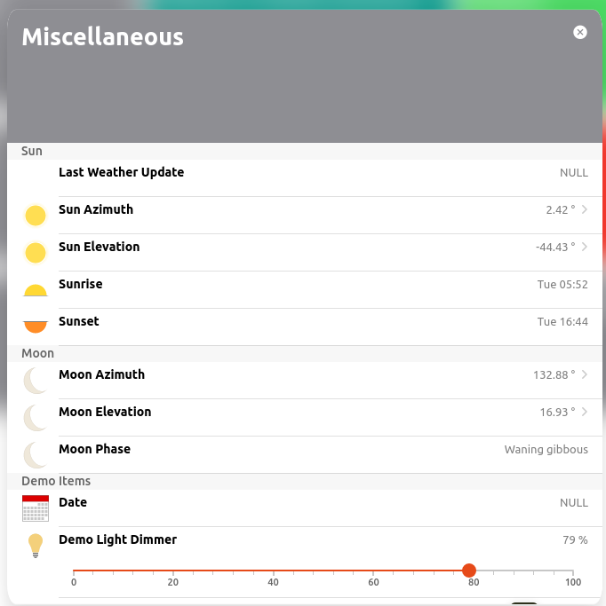

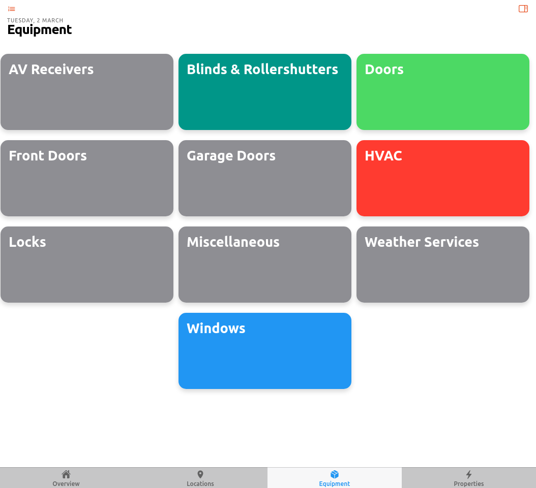

# Equipment Tab
Each equipment type is represented by a card showing a list similar to that shown on the Locations card. Each instance of the equipment is shown with a gray bar, and the equipment name and each Point/Property is shown in a list under that title.
Equipment tab
Equipment card
Also notice how an Equipment can be an abstract concept where necessary. In this case the sun is modeled as an Equipment.

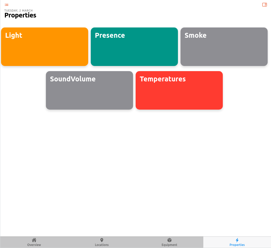

# Properties Tab

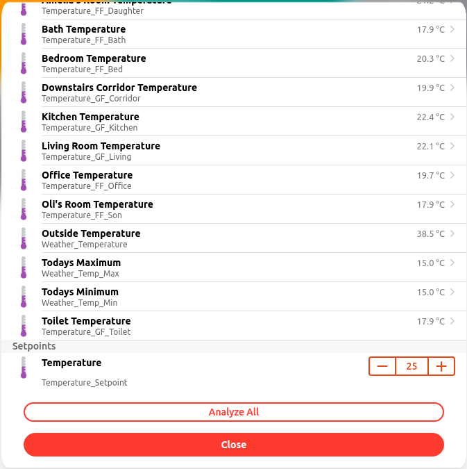

Each Point Item that has a Property tag is represented by a card showing each instance of that Property in the list. Unlike the other tabs, the gray bars here represent the Point tags and each Item with that Point is listed under that. What this means is for something like the Temperature Property one will have a set of all the temperature Measurements grouped together, and then all the temperature Setpoints grouped together, all on the same Temperature card.
Properties tab
Temperature card

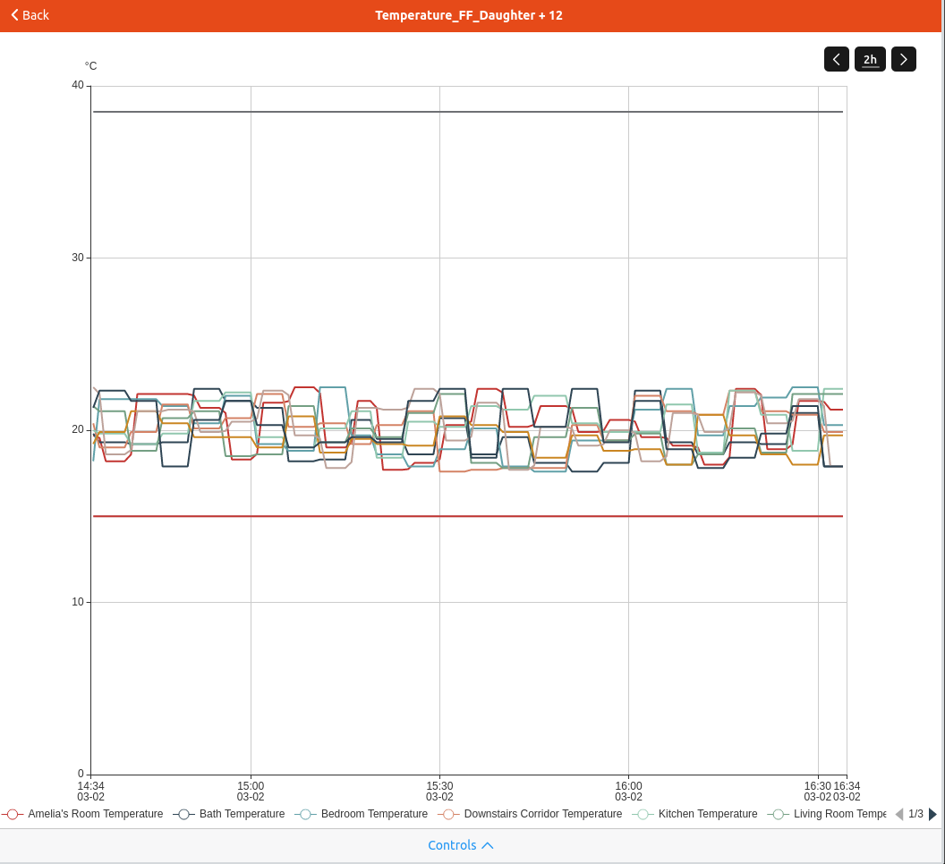

On the bottom of each card in the properties tab there is an "Analyze All" button. Clicking on that will bring up a chart showing the history of all the Items on that card over time. You can hide Items from the chart if it is too busy and change many other chart settings in the control tab under the chart.
Properties chart
Now persistence is starting to pay off!
If you've customized the chart and want to return to the same chart again, you can save it and a new Chart Page will be created showing those Items with those settings.

On any given tab the order of the cards can be adjusted and spacers inserted to group like cards together. For example, in the Locations tab screen shot above, all the rooms on a floor are grouped together and a spacer added to indicate which floor is represented.

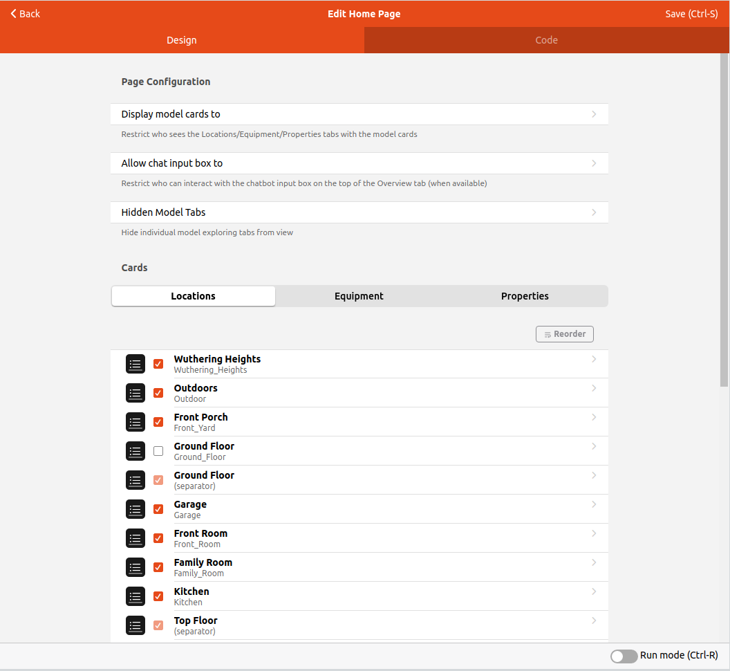

To adjust those settings, while logged in as an administration user, click on the pencil icon in the upper right corner of the Locations tab. This will open the customization page.
Pencil icon
Overview edit page
There are a few global settings for the overview page itself, and then each of the three auto generated tabs have their own settings.

Below these settings one can select one of the three tabs to customize. This will list all the possible cards that can be shown on that tab based on your model. MainUI will only show those cards that have something in them, even if that card is selected to be shown. Unchecking a card will prevent it from being shown on that tab even if it does have entries in it.
Next to each card entry there is a black and white icon that will open that card's customization form when clicked.

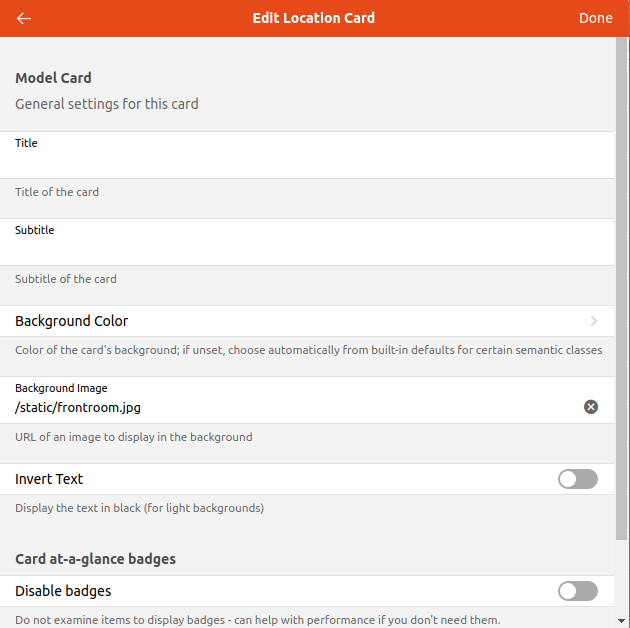

To customize a given card, click on the menu icon and select "Configure Card". This will open a form with customization options.
customize location card form
# Basic Settings
Instead of using the Item's Label and parent Group as the Title and Subtitle of the card, these can be overridden and manually set. Expressions can be used to make the Title and Subtitle change based on the states of Items or other conditions.
By default a background color is chosen based on the semantic tag. This default can be overridden here.
# Background Image
Using this feature may require a bit more work.
If you find a picture on the Internet that allows cross linking, all you need to do is put the URL of that picture in this field and MainUI will load it and use it as the background for the card. You may also wish to use your own images instead of something downloaded from the Internet. However, remember that text and icons will be displayed on top of the image. So regardless of the source, you might need to modify the original image to make it look good. For example, one might use high contrast images (e.g. architectural drawings and water color paintings) as background images. However, those images tend to be very light with very high contrast which makes both white and black text unreadable in many cases.
