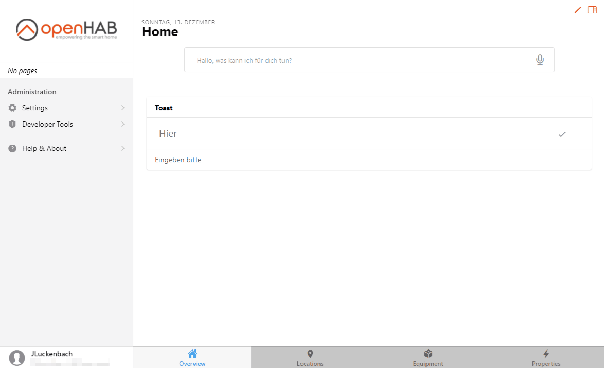

# Through User Interface
Log into your admin account (if not already done). Navigate to Settings and have a look for the add-ons section. Search for the desired add-on in the categories and press 'install'.
installing Add-ons through UI

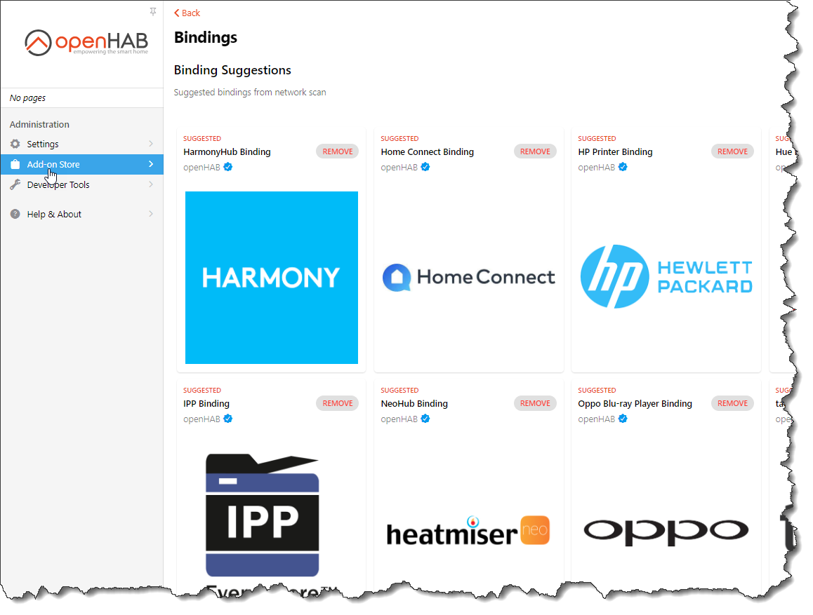

Alternatively navigate to Add-on Store. The openHAB framework will already have scanned your PC and LAN to discover home automation equipment in your system. Based on the discovery results it will show the add-ons that it recommends to install. Choose the desired add-on and press 'install'.
