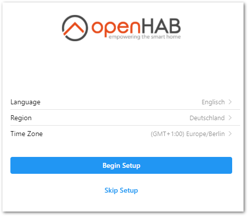

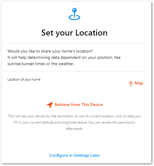

After creating an admin user, you will be guided through a first-time setup wizard. Start by setting your language, region, and time zone. You can also set your location, or skip this step and complete it later.

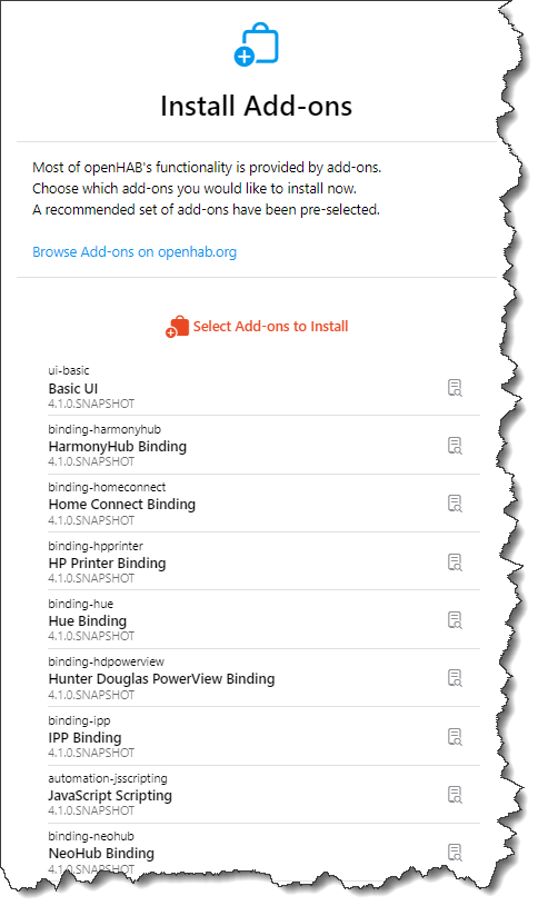

You now have the option to install openHAB add-ons. The openHAB system does an automatic scan to discover home automation equipment and software on your PC and LAN. Based on the scan result it recommends suggested add-ons to install. You can modify the list of add-ons. However do this only if you already know that you will need specific add-ons (e.g. if you're upgrading from an older openHAB system). Or skip this step if you prefer to install add-ons individually later. You can always install/remove add-ons in the future so you can modify and improve your system over time.
addons wizard

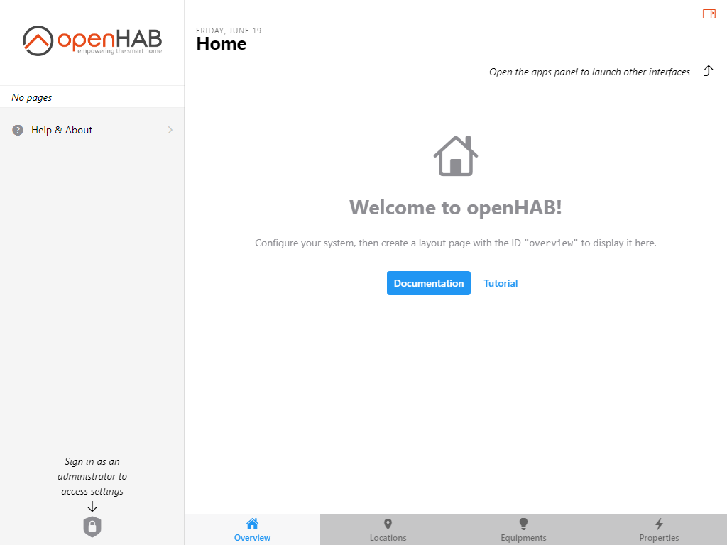

After finishing the wizard you will get a welcome message and be redirected to your dashboard.
welcome wizard
welcome page

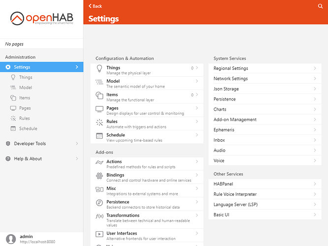

  1. In the left-hand menu under Administration, select Settings to open the Settings page.
    initial settings

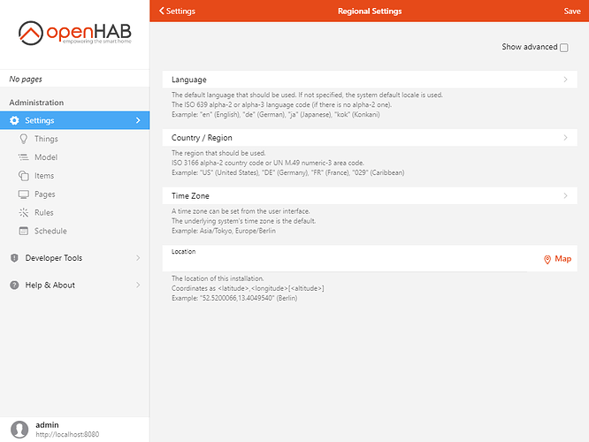

  2. Under System Settings, select Regional Settings.
    regional settings
  3. Under Location, click the Map button to add your geographic coordinates.
  4. If you also want to set your measurement system, click "Show advanced" and choose between Metric and Imperial.
