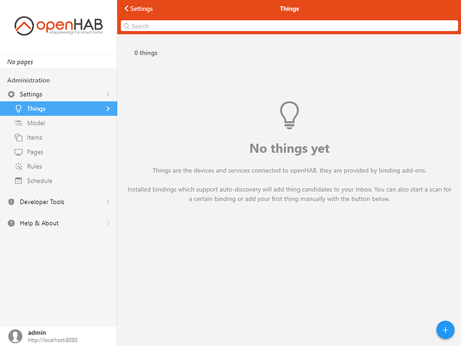

After logging in as an administrator, click on Settings from the sidebar, then click on Things.
empty things menu
Click on the blue "+" button located at the bottom-right corner.

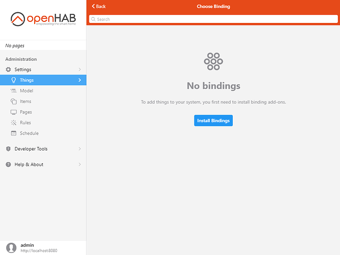

Since you have no bindings, this screen will appear:
choose binding
Click on Install Bindings.

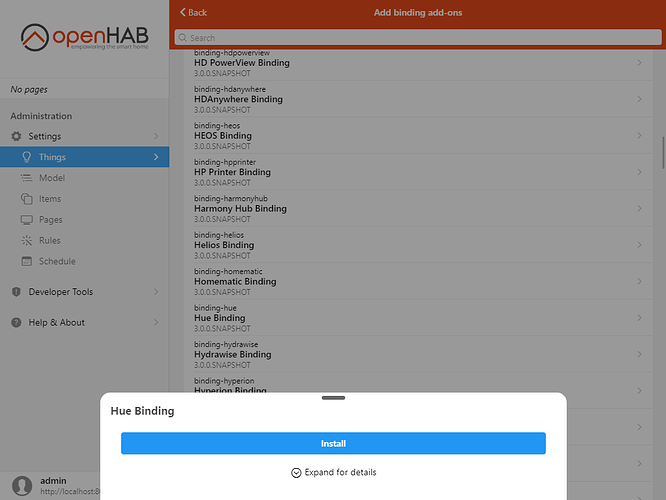

Look for the Hue binding. Note the search bar at the top can help find bindings quickly by filtering the long list. Click on the binding, then on Install.
install hue

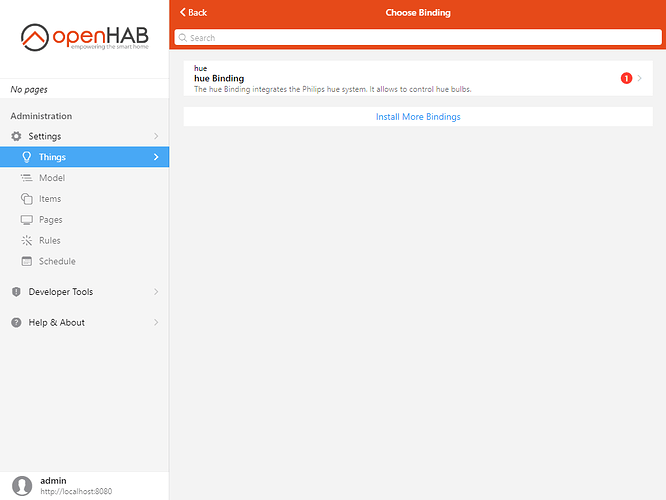

Wait for it to disappear from the list, then click < Back (or use the browser controls). The Hue binding will now appear on the previous screen. You will notice that the auto-discovery has already detected something (note the red "1" badge).

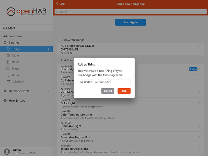

Click on the discovered Hue Bridge.
add hue bridge
openHAB will ask you to confirm or change the label/name. Click OK after naming the new Thing.

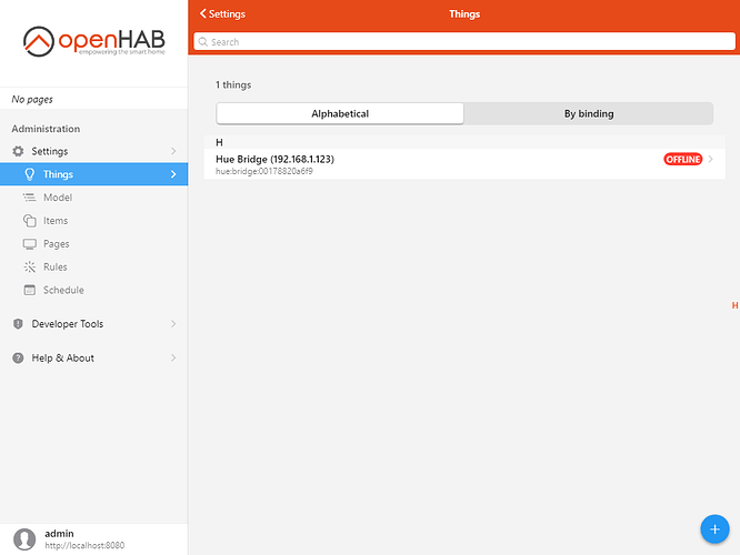

You will be taken back to the Things page, where the Hue Bridge should now appear.
hue bridge offline

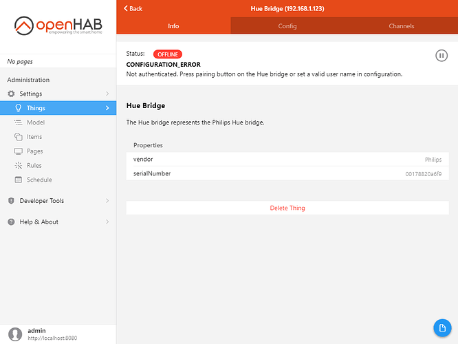

However, we can see that it's marked offline. To find out why we can click on the Hue Bridge.
hue bridge config error

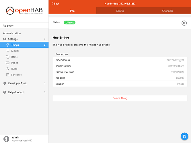

The error description below the status gives some more information: You have to press the physical button on the device to let openHAB authenticate to it. Once you've done this, the Thing will become online.
hue bridge online

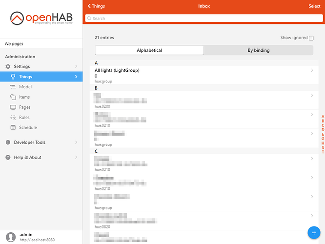

This means that there are newly discovered devices that you can add. Since the Hue bridge is now working, the binding has detected all the Hue devices (bulbs, switches and so on) attached to it.
The Inbox shows a consolidated view of all the discovery results which can sorted alphabetically or grouped by binding type (see tabs). Alternatively, you can also click on the "+" button to get a per-binding view and the ability to perform a new scan.
Click Inbox.
dicsovered hue things

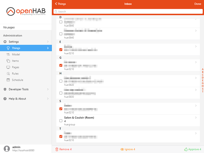

You can either click on an individual thing to see actions related to it, or you can click on Select in the top-right corner to add check boxes beside items, which will allow you to perform actions on several inbox entries at once.
hue individual add
hue bulk add
These actions are:
  • Approve: To promote the candidate from the Inbox to a Thing.
  • Ignore: To hide the candidate from the list (you will be able to see it again and un-ignore it by clicking on "Show ignored" above the list).
  • Remove: To remove the candidate from the Inbox (it might be detected again later).

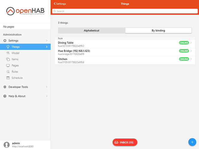

Now go back to Things. The newly approved Hue Things should appear on the list.
hue things added
You now have the Bridge Thing and the two light bulbs added to openHAB. Thankfully most of the bindings you will work with in openHAB will work in this simple way. However, there are some technologies that require a bit more manual configuration.
