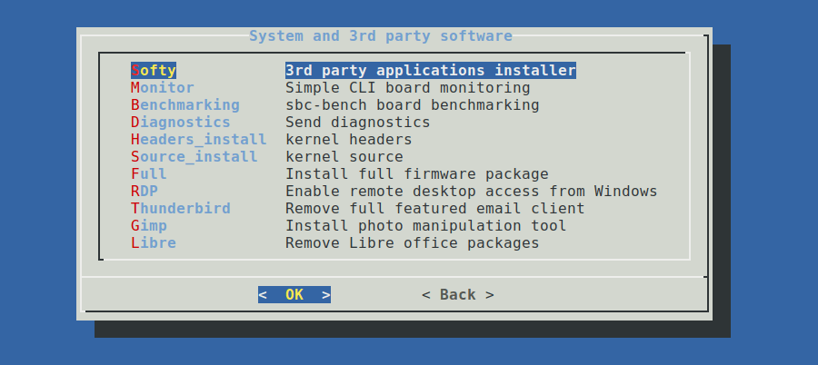

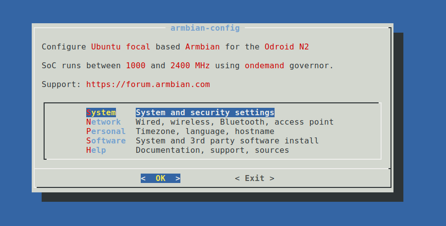

- Run armbian-config
sudo armbian-config

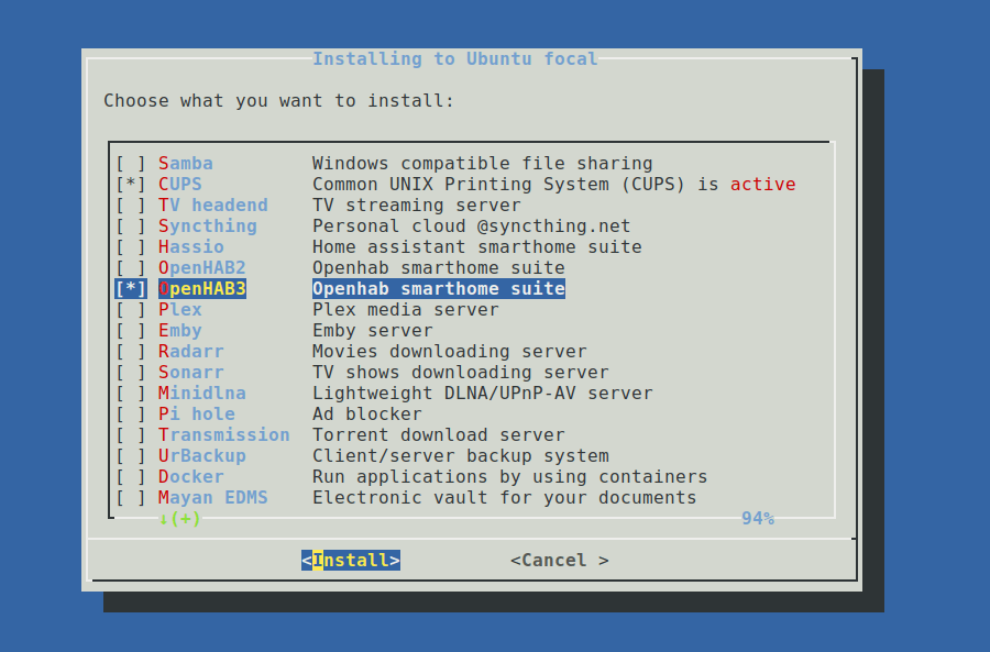

Select OpenHAB2 (old version) or OpenHAB3 with SPACE and press ENTER

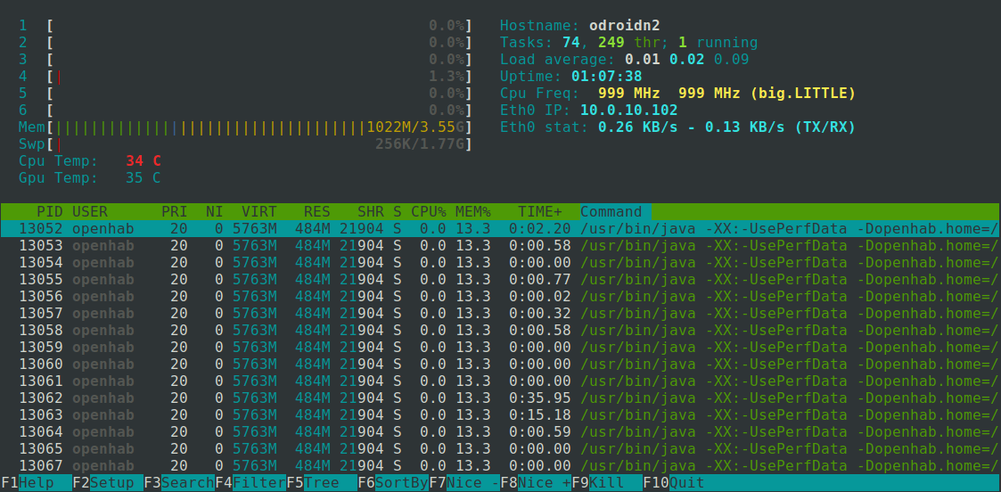

Wait 5 to 10 minutes depending on your hardware. During this time you can leave armbian-config and check if installation was successful by checking what openhab is doing on the system:
sudo htop -u openhab
If you don't see any openhab activities, something went wrong.
