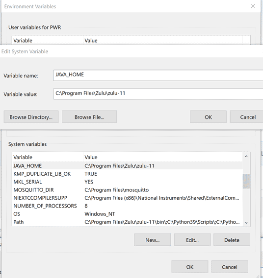

# Set the JAVA_HOME System Environment Variable in Windows
Note: If you have installed Java 21, you may skip this step because the JAVA_HOME environment variable was created during installation.
  • Navigate to: Control Panel ➡️ System and Security ➡️ System ➡️ Advanced System Settings ➡️ Environment Variables ➡️ System Variables
  • Create a New System Variable named JAVA_HOME (or update the existing one) to match the installation directory of the Java Platform chosen and installed in the step Prerequisites.
JAVA_HOME

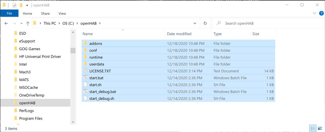

The openHAB runtime is distributed using a platform-independent zip file. To install it, follow these simple steps:
  1. Download the latest Windows Stable or Snapshot ZIP archive file for manual installation from the Download (opens new window) page.
  2. Unzip the file in your chosen directory (e.g. C:\openHAB)
    openHAB Folders
  3. Start the server: Launch the runtime by executing the script C:\openHAB\start.bat and wait a while for it to start and complete.

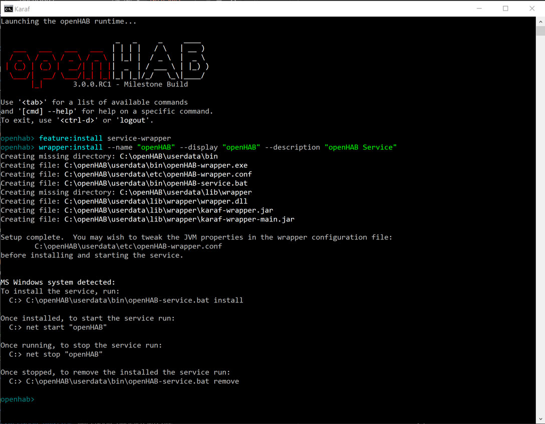

  2. Issue the following two commands in your openHAB console:
    feature:install service-wrapper
    wrapper:install --name "openHAB" --display "openHAB" --description "openHAB Service"
    Wrapper Install_Windows
  3. Shutdown the openHAB instance by typing logout in the currently running console.

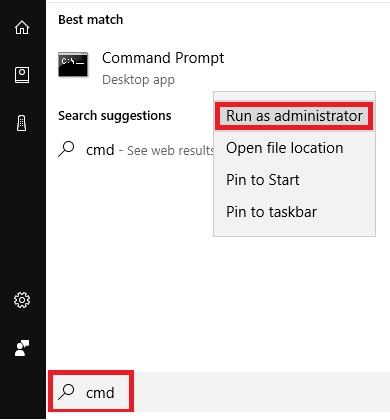

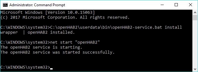

  5. Open an elevated command prompt and type the following commands:
    C:\openHAB\userdata\bin\openHAB-service.bat install
    net start "openHAB"
    Admin cmd
    Wrapper_Start_Windows

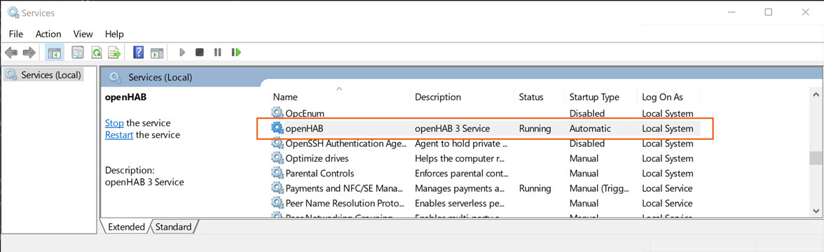

  6. Your openHAB Windows service is now installed and running.
    Validate proper operations by browsing to http://localhost:8080 and verifying that the Windows Service is running and set to Automatic Startup type. Use services.msc and find the openHAB service. Or by logging in with an SSH client to the console (see info below)
    Windows Service
# File Locations
Assuming a successful install, you will now have various folders inside C:\openHAB:
Windows Installation
openHAB application C:\openHAB\runtime
Additional add-on files C:\openHAB\addons
Site configuration C:\openHAB\conf
Log files C:\openHAB\userdata\logs
Userdata like rrd4j databases C:\openHAB\userdata
Service configuration C:\openHAB\userdata\etc

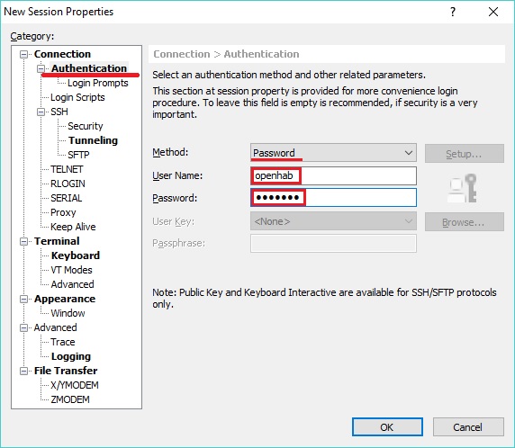

# Connecting to the openHAB console

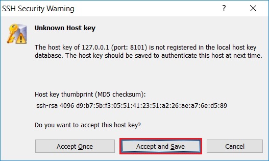

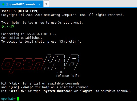

You can connect to openHAB's console using the the C:\openHAB\runtime\bin\client.bat script on the local machine. Alternatively, you can use a standard SSH client:
  1. Install an SSH client application, e.g., Putty (opens new window), KiTTY (opens new window) or Xshell (opens new window)

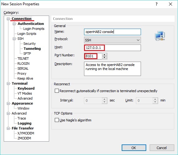

  2. Setup a session with the following parameters:
    Host: 127.0.0.1
    Port: 8101
    Username: openhab
    Password: habopen
SSH Connection 1
SSH Connection 2
SSH Connection 3
