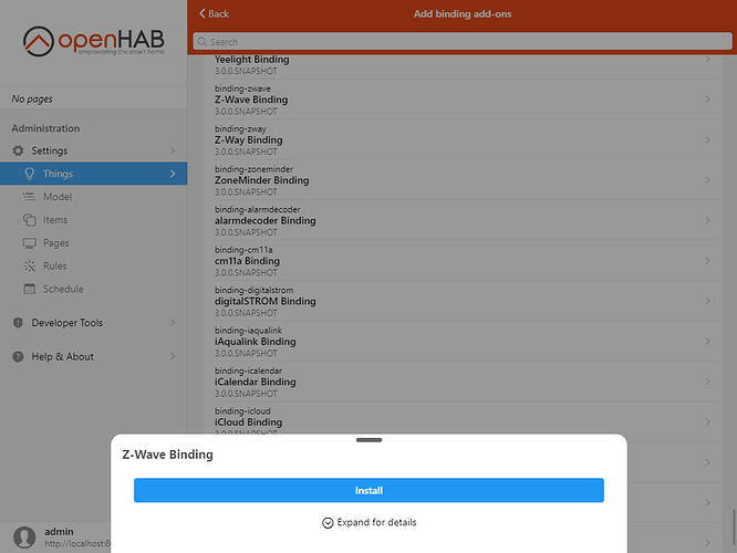

We need to install the Z-Wave binding. Click "Install More Bindings".
install zwave
Find the Z-Wave binding, click on it, then click Install.

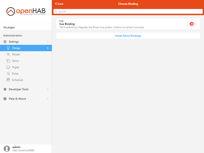

installing zwave
Wait for it to disappear from the list, then go back.

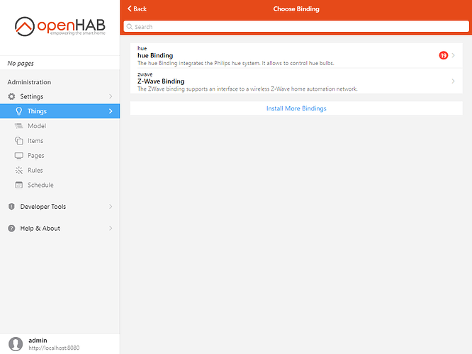

installed zwave
# Create the Bridge Thing
Click on the new option: Z-Wave Binding.

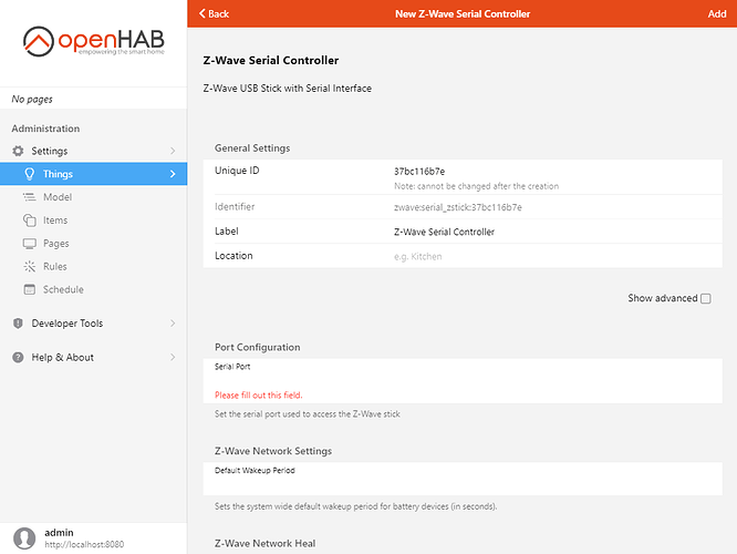

Click on Z-Wave Serial Controller to add the controller.
add zwave controller
We need to specify one required parameter, the serial port. In certain cases, depending on your system, you will be provided with a list of options for this setting.
zwave port config
Choose the correct port, alter the name and/or ID of the controller Thing, then click Add in the top-right corner.
