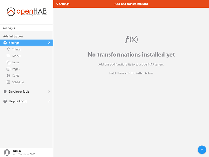

This device publishes JSON formatted messages, so we need to install an add-on that can process JSON: the JSONPath Transformation. A Transformation takes incoming data and transformes it somehow. In this case it will extract certain fields from the JSON. From Settings, click on Transformations under Add-ons.
choose transformation

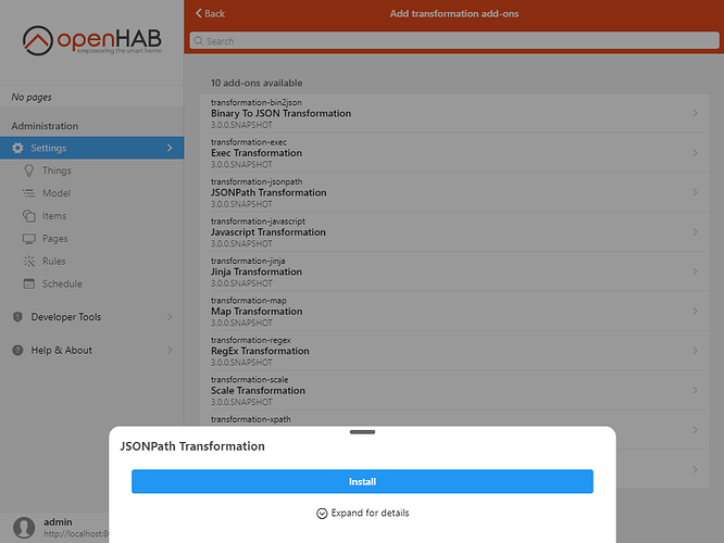

Click on the blue "+" button and find JSONPath Transformation. Click on it, then click Install.
install_jsonpath

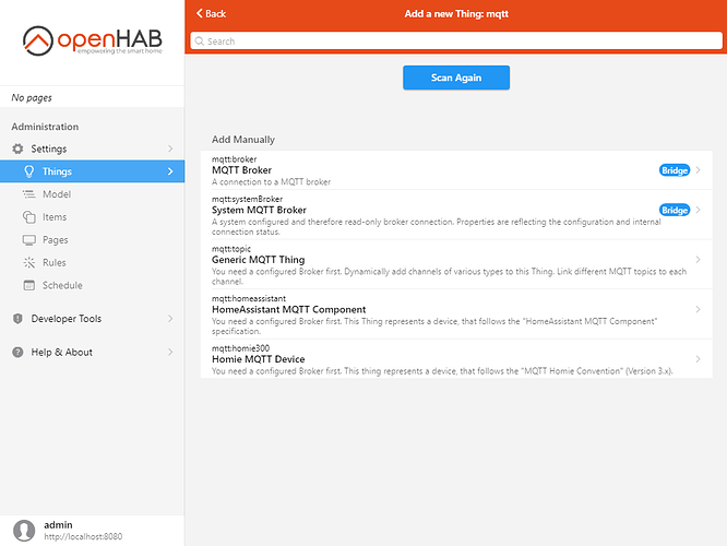

Choose "MQTT Binding", then choose "MQTT Broker".

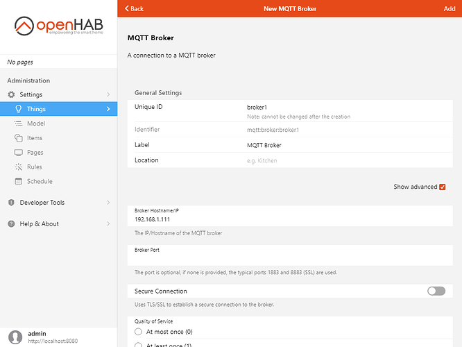

Fill in the details to connect to the broker. You may also alter its ID and name. If you need credentials to connect to the broker, click on "Show advanced" to reveal additional options, including Username and Password.
mqtt bridge config
# Create the Generic MQTT Thing
Now we have to add the plant sensor itself as a generic Thing.
On the Things page, first verify that the broker is indeed present and online; if so, click on the blue "+" button then on the MQTT Binding.
Note that you might have results already appearing under "Discovered things" if you happen to have auto-discoverable devices publishing messages to the broker.
In our case, click on Generic MQTT Thing under "Add manually".

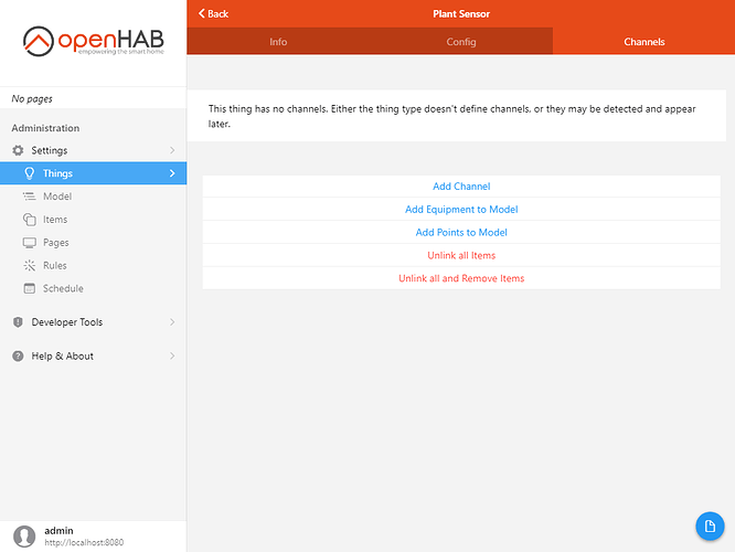

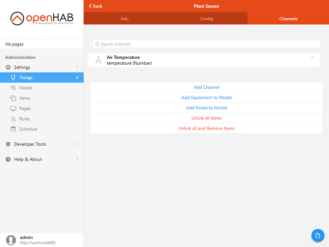

Back on the Things page, choose the Thing you created. It should be marked online, but it will not have any Channels on the Channel tab. You have to configure them yourself.
mqtt generic thing
Click on Add Channel.
Let's add the temperature first. Fill in the "channel identifier" and "Label" fields accordingly: for instance, temperature as the identifier and Air Temperature as the label.

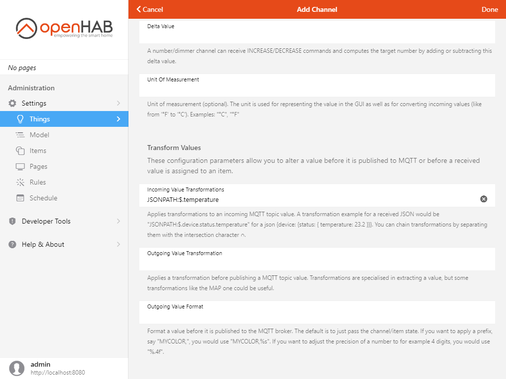

This channel will provide numbers, therefore choose the Number value channel type for the new channel. Scroll down and enter the MQTT topic receiving the JSON message in the MQTT State Topic field. We don't want this channel to provide the whole message, only the temperature part. Extracting the temperature from the message can be done using a transformation.
Click on "Show advanced" above MQTT State Topic to reveal more settings.
Scroll down, find the "Incoming Value Transformations" setting, and specify the transformation to apply there:
JSONPATH:$.temperature
mqtt temp channel
Click Done in the title bar to add the channel. It should now be added to the Channels tab.
mqtt temp channel created

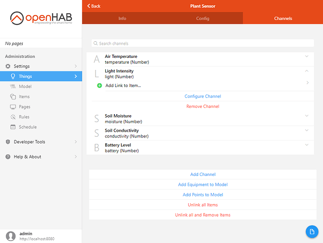

Repeat the procedure for the other channels:
Value Label Type Incoming value transformation
light Light Intensity Number value JSONPATH:$.light
moisture Soil Moisture Number value JSONPATH:$.moisture
conductivity Soil Conductivity Number value JSONPATH:$.conductivity
battery Battery Level Number value JSONPATH:$.battery
All channels should specify the MQTT topic where the JSON message is published.
If you want to check the configuration for a channel, or if you made a mistake while adding it, open the channel details by clicking on it, and choose Configure Channel.
mqtt config channel
Note that you cannot change the channel type if you picked the wrong one. In that case, remove the channel by clicking on Remove Channel and then add it again.
