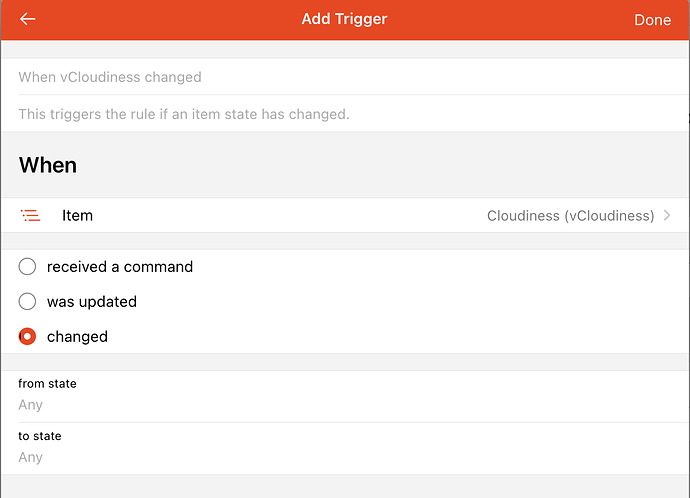

Under triggers, click on the green + icon labeled "Add Trigger" to define what events should cause this rule to run. This brings up a form that lets you choose the type of the trigger and enter some information about the trigger.
rule triggers dialog
We need an Item changed event to trigger this rule so it runs when the cloudiness percentage Item changes. So I select "Item Event" and select my Item and click "Pick" in the upper right corner.
pick item dialog
Choose "changed" since we only care when the Item changes. Notice the title and description is filled out with reasonable information.
rule trigger dialog
You will notice that there are "from state" and "to state" fields. These can be used to further narrow down when the rule triggers, but do not confuse these with conditions. You can only include a single state here (e.g. from state: ON to state: OFF). You cannot use comparison operations here (e.g. < 70) and need a condition for that. Therefore these are mostly useful with Switch, Contact, Player, and sometimes String Items. Any Item that has a range of values rather than a few discrete values will not use these.

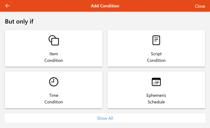

Click the green + icon under "But only if" labeled "Add Condition".
rule condition dialog

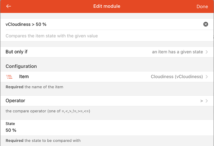

Choose Item Condition because we want to check the state of an Item and select the Item. Note, sometimes if the Item not part of the model it can be hard to find. If that happens to you, select any Item to start and then you can get a flat list of all your Items on the next screen.
In this case we want to check if the vCloudiness Item is >= to 50 %.
rule condition vCloudiness > 50%
Notice the %. This Item is a Number:Dimensionless representing a percentage. So I've used the units here. This will work with any supported units of measurement and there will be a warning in the logs if your Item has units but the "State" does not.

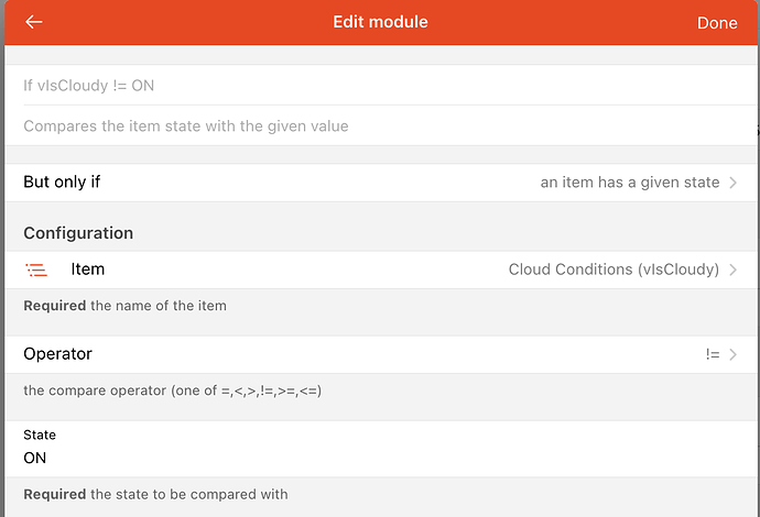

Next we don't want to run the actions if vIsCloudy is already ON.
rule condition vCloudiness != ON

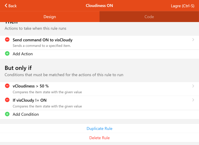

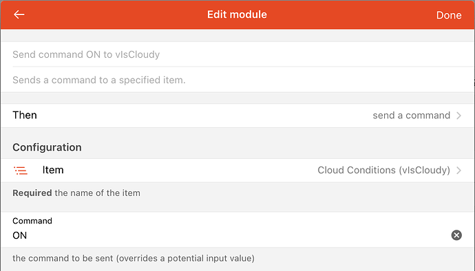

Finally, we want this rule to send the ON command when triggered and the conditions are met.
Click the green + icon labeled "Add Action" under the "Then" section and choose "Item Action". By now the steps should be familiar, select the Item, in this case vIsCloudy and you are presented with the Item action form. In this case we want to send command ON.
rule action send command ON
The rule is now done! Click Save and watch the log for errors and to see if the rule is working (more on that later).

Scroll to the bottom of the design tab for the rule we just created, and click Duplicate Rule button.

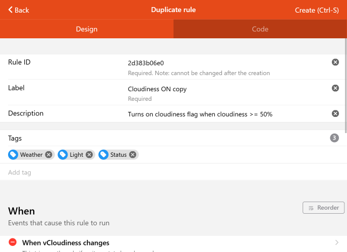

basic rule duplicate
Edit "Rule ID", "Label" and "Description" as appropriate.
basic rule duplicate 2
Scroll down to "Then" and click the "Send command ON to visCloudy" Action to edit it. Change the label and the command so that they reflect OFF instead of ON.
Using the same logic, click and edit the two conditions under "But only if" to require <= 50% and = ON instead.
Click Create in the upper right corner to save the new rule.

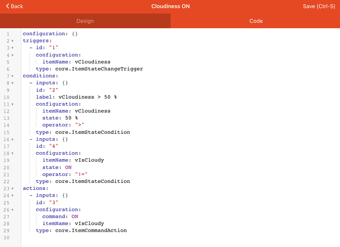

First, open the code tab for the rule we just created. This will show a text version of the rule. You should see a section corresponding to each of the parts of the rule (but note that the order of the configured pieces may not match.
basic rule YAML
Copy the text shown here to the clipboard.
Create a new rule (see above), enter the metadata for the rule (this time we are commanding the Item to OFF) and then open the code tab for this new rule. Paste the contents of the clipboard to the code tab and make the edits as necessary.
In this case we want to change the operator for the first condition to <, the state for the second condition to OFF, and the command for the action to OFF. The code would look like this:
basic rule YAML modified

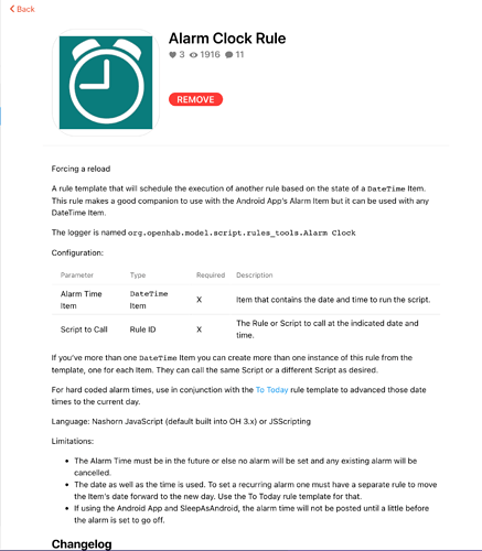

In MainUI click on a rule template that seems to do what you want. This will open it's documentation page which explains how the template works, configuration parameters, dependencies, etc.
alarm clock rule template
To install the template, click on "Add" next to the template's logo. If installation was successful, you can now create one or more rules based on the template.

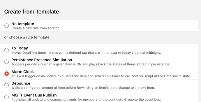

Fill out the Rule's metadata as usual. However, now you will see a "Create from Template" section listing all the installed templates. Choose the template you want to base this rule on.
create rule from template

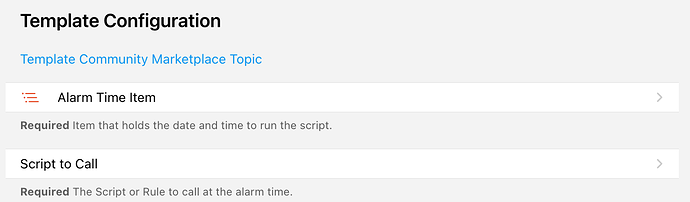

The bottom of the form will change from the three sections described previously to a form showing the parameters the rule template defines.
configure rule
In this case, the parameters are selecting a DateTime Item to trigger the rule and which defines the "alarm time" and a "Script" to call when at the date and time in that DateTime Item.

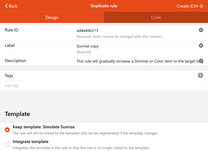

# Customization of Rules Created From Templates
What if a rule template does almost what you need but not everything? You could simply modify the template-based rule itself. But, if you ever were to regenerate the rule in the future, your modifications would be lost. A better solution is to make a copy of the template based rule that isn't associated with the template, and then modify that. This can be achieved by scrolling to the bottom of the Design tab of the rule and clicking Duplicate Rule button. When duplicated, template-based rules will present you with a choice:
duplicate rule stub
If you choose "Keep template", the duplicate will still be associated with the template, and you can optionally change some of the parameters before saving the duplicate. If you choose "Integrate template", the duplicate will not be associated with the template, and it can never be regenerated. By modifying a duplicate that has "integrated the template", the modifications can never be lost due to regeneration in the future. Don't be afraid to take a rule template as a starting point and further refine it.
