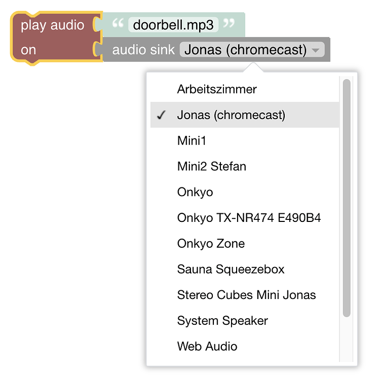

- Audio Sinks
- Audio devices are automatically added by their bindings as sinks in openHAB

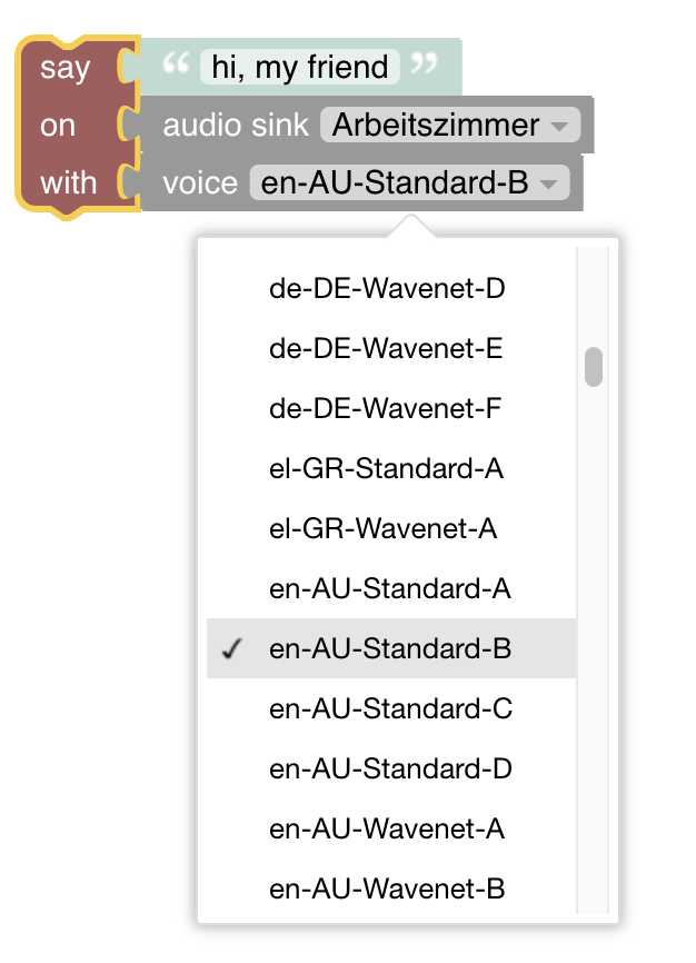

- Text-To-Speech
- In order to use text-to-speech, you need to install at least one TTS service (opens new window).
- see openHAB Voice (opens new window) for more information
- in case you only have one TTS service, this becomes your default TTS services. In case you have several TTS services installed, you have to configure one of them as the default which can be done in your services.cfg (opens new window). See more on that special case here (opens new window)

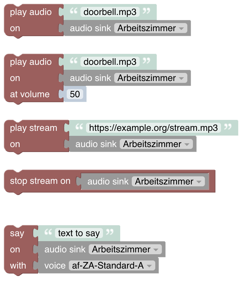

# Play Audio
Function: Plays an audio file on an audio sink
- the audio file must reside in the sounds-folder of openHAB that can be found here (opens new window)
- all available audio sinks are automatically provided by openHABs blocklies
Also view Playing sounds on audio sinks (opens new window)

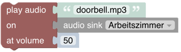

# Play Audio with Volume
Function: Plays an audio file on an audio sink and setting the volume at the same time
same as above but also allowing to provide the volume at the same time

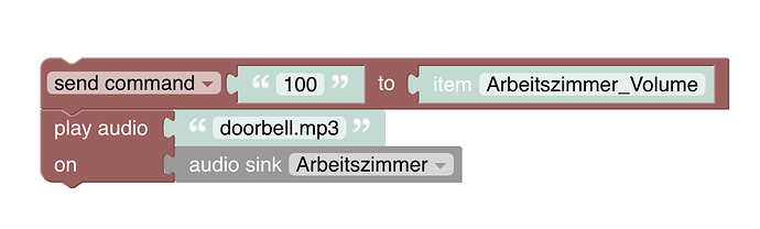

Known issue workaround: In several cases (like the Google Minis) it is known that setting the volume together with playing the sound results into only setting the volume either during playing the sound or even after the sound has played. In case this happens the more robust approach is as follows
- Search for the thing of that particular sink and add an in item for the volume channel
- Then create the following block sequence

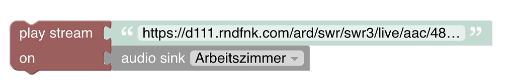

# Play Stream
Function: Starts a stream playing on an audio sink
- The audio streams must be reachable from the openHAB server and can therefore be either internally or externally hosted
- All available audio sinks are automatically provided by openHAB's blocklies
- Changing the volume needs to be done via the thing volume channel linked to the sink device by sending the respective volume level command to that item
More about that topic can be viewed at Play Stream (opens new window)
# Stop Stream
Function: Stops playing the current stream of the specified audio sink
# Say
Function: Sends the given text to the sink by using the default Text-to-Speech-Service to translate the text based on the chosen language voice into a stream which is then played on that device sink.
More about that topic can be viewed at Using Text-to-speach easily with blocks (opens new window)
