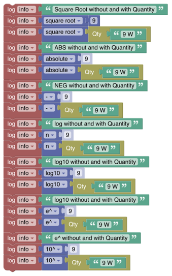

The Math section mainly consists of standard Blockly blocks. Two new math blocks were added for bitwise operations:
# Quantity Type support
Blockly allows to use Quantity types to do its math operations. This means that Quantity States can directly be used as an input for math operation blocks.
Here are some examples for math operations with unit-accompanied values:
quantity-math-operations
Note that there is a special case on min/max if the inputs are not of equal type. In this case an error will be shown to the user:

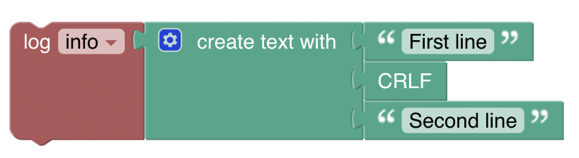

# CRLF
CRLF stands for carriage-return / line-feed which is a technical term for adding a new line in a string
crlf
Function: return a newline character to be added to a string.
Example:
crlf

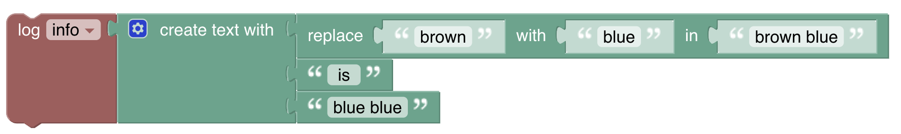

# Text Replace
text-replace
Function: Allows to replace something that is defined by the pattern in the origin-text with what is provided in replacement. Note that the pattern can be just a text or also regex expression.
Example:
text-replace example

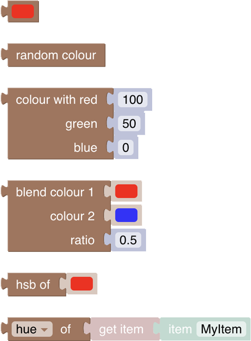

The Colors section simplifies the selection of Color Values. Technically these color RGB values are provided as a hexadecimal combination of the three values for red, green and blue (hence RGB). Each of the individual colors can range from 0 - 255 or 0-FF (hexadecimal). A color of r=255, g=255, b=255 would therefore result into #ffffff preceded by a # which identifies it as a hexadecimal number.
colors-overview
Note that typically RGB values are not used within openHAB for color states but instead the Color-Type expects a HSB Type. See the special hsb-conversion block below.
Blockly supports the following use cases:
  • pick a color to return the value as an RGB type
  • chose a random color as RGB type
  • define an RGB color based on red, green and blue.
  • blend two colors with a ratio - this block can be used to dynamically transition from one color to the other by applying the ratio as a computed value in a rule.
  • calculate the HSB value of the RGB value
  • get hue, saturation or brightness from a HSB Type Color Status of an Item
# Color Picker
color-picker
Function: Lets the user pick from a (limited) set of colors and returns a the hexadecimal number (in the above case the value = #33cc00.
# Random Color
get-random-color
Function: Returns a random color as a hexcode
# Create RGB color
create-rgb-color
Function: Returns a color by mixing the given values in a range from 0 - 255 for reg, green and blue as a hexcode

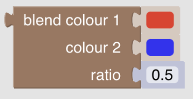

# Blend two colors
blend-two-colors
Function: Blends two colors chosen via a color picker into one color by the given ratio.
TIP
this could be used for example with a loop that changes the ratio from 0 to 1 to blend the first color into a second
# Create HSB-color from RGB color (openHAB)
get-hsb-of
HSB stands for hue-saturation-brightness which is a different way of describing a color. An RGB color can therefore be converted equally into an HSB-color.
Function: This a special openHAB block that converts a hexadecimal color code from one of the above blocks into a String that is required when sending a color command to any item that accepts a color.
  • use that block and connect one of the above blocks into that one to be able to retrieve the HSB value of that block.
Example
get-hsb-of-example
# Retrieve indidivual HSB values from an Item state
This block allows to retrieve the individual values of an Item’s HSB color state by returning
  • Hue,
  • Saturation,
  • or Brightness

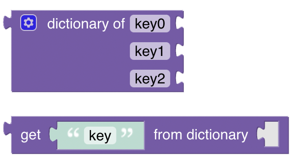

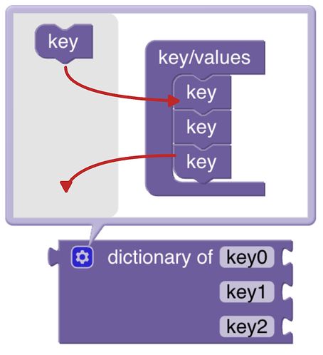

The dictionary is a holder for key value pairs that can be passed along as one. Add or remove new key value pairs by clicking on the cog icon to open the popup of the dictionary block (finally click on the cog again to close the popup). Then drag the key block on the upper left into the key/value bracket on the right like depicted below:
dictionary

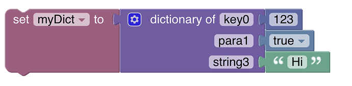

Rename the keys as required and then add any value block type to the related key:
Example:
dictionary-example
# get value of key from dictionary
dictionary-getkey
Function: Retrieves the value of the key in the given directory
