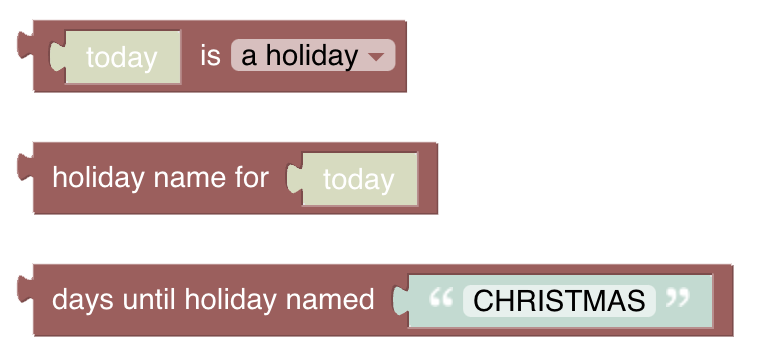

# Holiday, weekend or weekday check
ephemeris-is
Function: this block checks if the given date is a holiday, weekday or weekend.
Type: boolean true or false

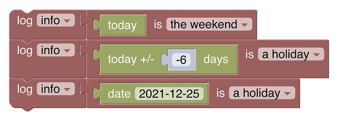

Examples
ephemeris-is-example
# Get the holiday name for a particular date
ephemeris-get-name
Function: Returns the holiday name for the given date. Will return null if no holiday is found for the date.
Type: String
# Get the number of days until a specific holiday
ephemeris-days-until
Function: Return the number of days until the given holiday name, or -1 if the holiday is not found.
Type: number
