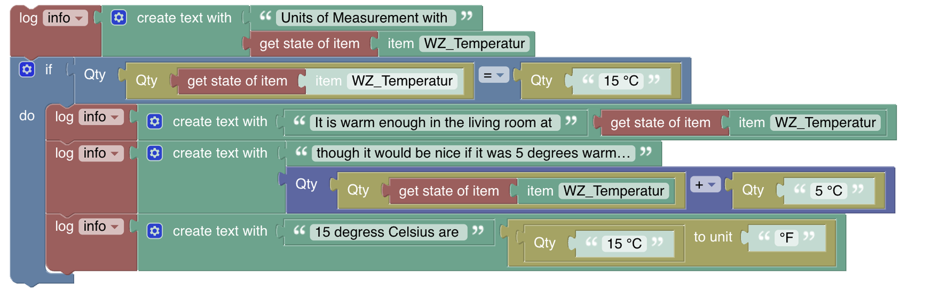

The following example block gives a good idea of what can be done with the Unit of Measurement blocks

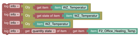

# Smart block input type handling
Note that the block is smart enough to either take either one of the three blocks
  • "get item block" (which returns the whole Item object and from which the block retrieves state value)
  • "get state item block" (which returns the Item state and from which the block retrieves state value)
  • "item block" (which returns only the name of the Item and from which the block retrieves quantity state of the Item)
or you can directly access the to retrieve the quantity state.
uom-smart-input-handling
Blockly cannot detect the type that is contained in a variable so it expects an item object. This allows to iterate over a group of item members which returns a list of item objects:
uom-#-var
This approach is valid for all blocks in this section except Quantity Conversion which expects a Quantity.

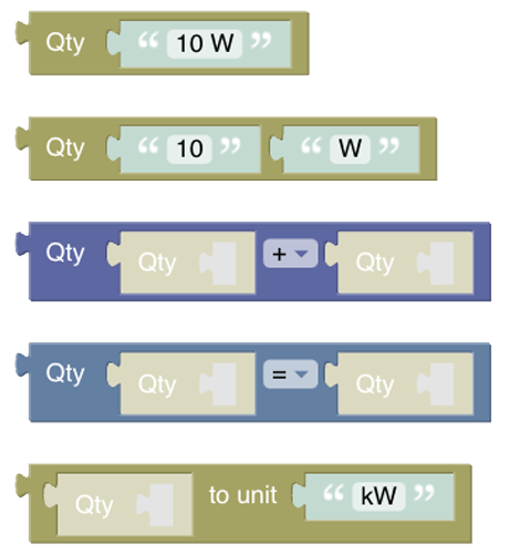

A Quantity is the combination of a value and a unit of measurement, which means that the blocks require a Quantity as an input and generate a Quantity as an output. Even though the quantity block looks similar to the standard text block it actually wraps a string into a Quantity type.
Function: The following block takes a string of "10 W" (10 Watts) and converts into a quantity of 10 W which then can be used for computations. Instead of using a constant string, the block can also take the output of an item or a variable and convert it into a quantity. The second block below allows easier handling in some special cases where you like to supply value and unit seperately.
blockly-quantity blockly-quantity-unit blockly-quantity-temperature-item
# Quantity computation
Function: The block allows to compute the following operations with two quantities:
  • addition
  • substraction
  • division
  • multiplication
It only takes a quantity block as an input and also returns a quantity as an output.

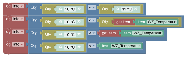

Function: The block allows to compare two quantities with the following operands which will return a boolean as a result.
blockly-quantity-comparison

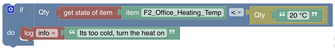

The following shows how it can be used in an if-statement:
blockly-quantity-comparison-if
More examples:
blockly-quantity-comparison-examples
# Quantity Conversion
Function: The block provides the conversion from one quantity to another.
blockly-quantity-conversion
The result of that operation would be 0.01 kW.
The following examples show how to use it with an Item:
blockly-quantity-conversion-item
