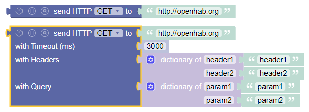

# HTTP Request GET
Function: Send an HTTP GET request to a server and receive the response
The simplest form is shown by default and accepts the destination URI as String, e.g., GET http://openhab.org. See below for an example of a GET request with query parameters (likehttp://example.com/api?param1=value1&param2=value2` (opens new window)).
http-get-simple
By activating the toggles the timeout, request headers and query parameters can be provided. Instead of creating a URI containing the query parameters, you can use the query parameter option and provide a Dictionary of query parameters. The provided parameters will automatically be URI encoded.

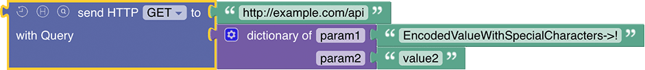

Another example shows how several query parameters can be provided using a Dictionary:
If you want to send a request with parameters like http://example.com/api?param1=value1&param2=value2, the request can be constructed as follows:
  • URI: http://example.com/api (opens new window) with two query parameters param1 and param2
    • where param1 has a value that contains special characters, like EncodedValueWithSpecialCharacters->!
    • and param2 has a value of value2
you can use the following block:
which results in the following request:
http://example.com/api?param1=EncodedValueWithSpecialCharacters->!&param2=value2 (opens new window)

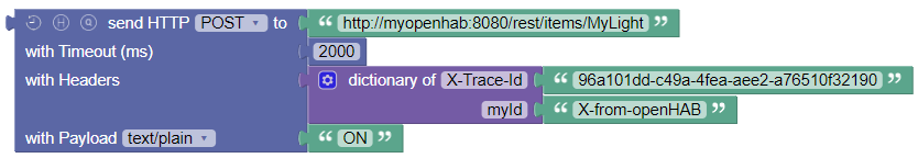

# HTTP Request POST
Function: Send an HTTP POST request to a server and receive the response

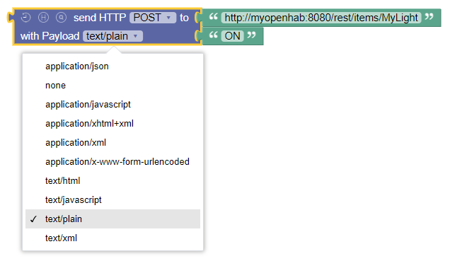

The simplest form is shown by default and accepts the destination URI as String and in comparison to the GET-Request adds a section for the payload which takes two parameters:
  • the MIME-type of the content to be sent
  • the content to be sent to the destination
For MIME-type application/json you can provide an object as content, and it will be converted to a JSON string. For application/x-www-form-urlencoded, you can provide a Dictionary and it will be URI encoded.
http-post-simple
Here is a more complex example that additionally sets a header and a timeout:
http-post-complex

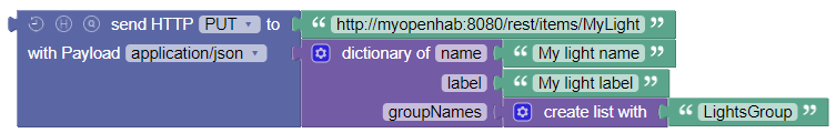

# HTTP Request PUT
Function: Send an HTTP PUT request to a server and receive the response
The simplest form is shown by default and accepts the destination URI as String and is similar in functionality to the POST-Request:
http-put-simple
Notice the construction of an object with a Dictionary also containing a List for the JSON payload.
