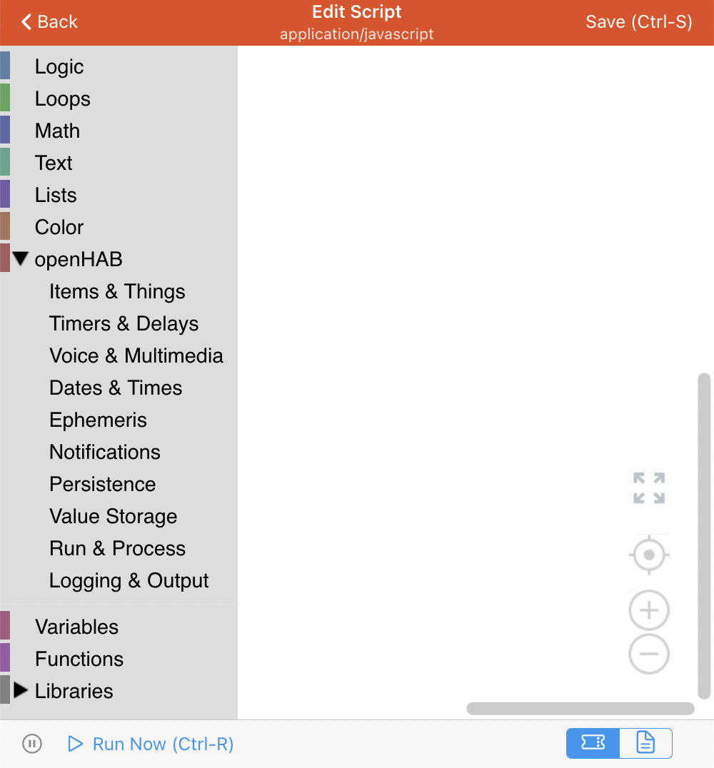

  • click on run-script-2 und you should now see this screen blockly-edit-screen
  • you can now click the toolbox-submenu to access all openHAB Blocks.
  • Drag and Drop the blocks to the white area

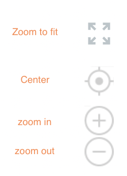

# Panning and Zooming
You can move around Blockly's workspace by clicking and dragging on the empty space, or by using two fingers on a touch screen or a trackpad.
Zooming can be done using either of these methods:
  • By pinching or stretching on a touch screen or a trackpad.
  • By holding Ctrl while dragging or moving with two fingers on the touch screen or trackpad.
  • With the on-screen controls:
    workspace-zoom-controls

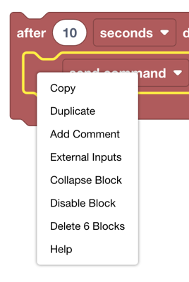

# Context Menu
A context menu is available when right-clicking on a block.
Blockly Context Menu
Right-clicking on an empty area in the workspace will pop up a slightly different context menu. In particular, Clean up Blocks will automatically move and arrange your blocks neatly.

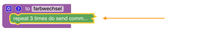

  • Collapse (expand) block: Shrinks the block to get a better overview
    Normal block view: expanded-block
    Collapsed view:
    collapsed-block

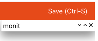

# Searching the workspace
Sometimes blockly rules become pretty big, and it is hard to find particular blocks in the rule. Therefore, a search functionality has been provided by pressing Cmd/Ctrl-F which opens a small search window in the top right (just below the "save"-label). After pressing Enter all found blocks that contain the search term are marked in black.
