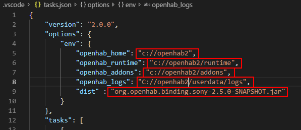

  5. Edit tasks.json and ...
    tasks.json changes
    1. Set openhab_* to the directories for your openHAB installation
    2. Set dist to the name of the JAR file Maven is producing in the target directory
    3. Save and close tasks.json
