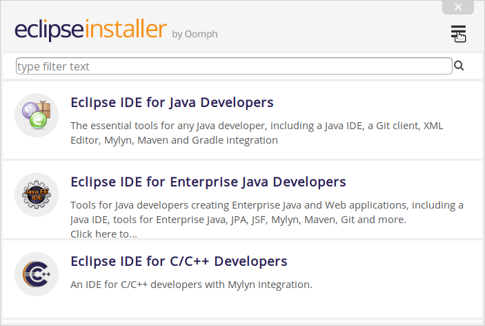

  2. Download the "Eclipse Installer": can be downloaded from the Eclipse web site (opens new window)

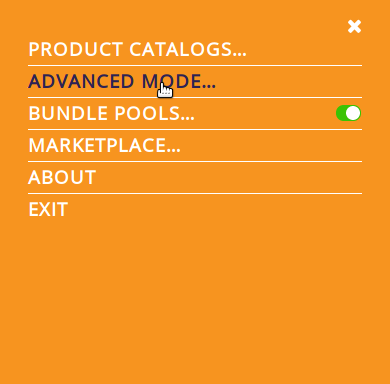

  3. Launch the Installer and on the menu on the top right (3 bars)
    installer
  4. Select ADVANCED MODE...

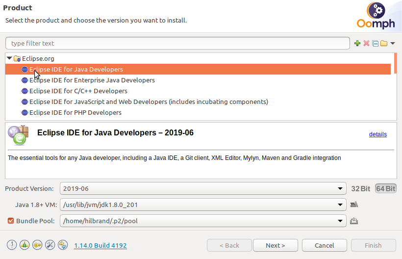

  5. Select Eclipse IDE for Java Developers. Select Next >.

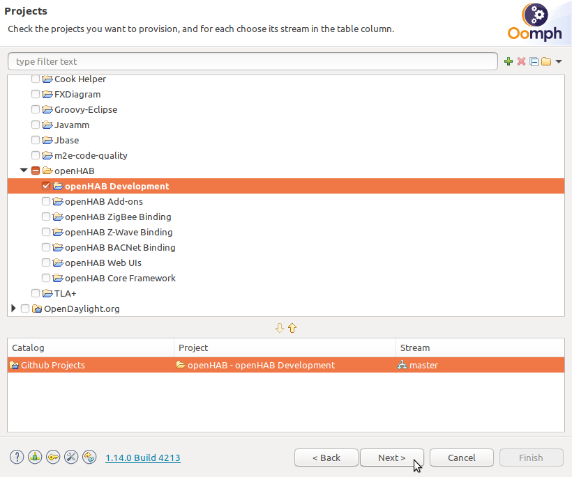

  6. Under GitHub Projects > openHAB select openHAB Development and any desired option from openHAB Add-ons (includes all add-ons from openhab-addons repo), openHAB ZigBee Binding or openHAB Z-Wave Binding.
    select projects
    Selection Install if
    openHAB Development Debug/Demo Environment (Required)
    openHAB Add-ons Add-ons Development
    openHAB ZigBee Binding ZigBee Binding Development
    openHAB Z-Wave Binding Z-Wave Binding Development
    openHAB BACNet Binding BACNet Binding Development
    openHAB Web UIs Web UIs Development
    openHAB Core Framework Core Framework Development

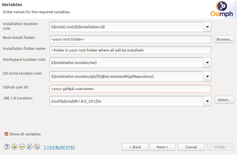

  7. Click Next>, verify/modify Root and install folder name. Click on Show all variables to open the window shown below.
    variables
    Explanation of some of the variables
    • Root install folder: The base folder where the Installation folder will be placed.
    • Installation folder name: This is the directory in the root install folder everything will be installed in.
    • GitHub user ID: This is your GitHub user name used to configure the cloned Git projects.

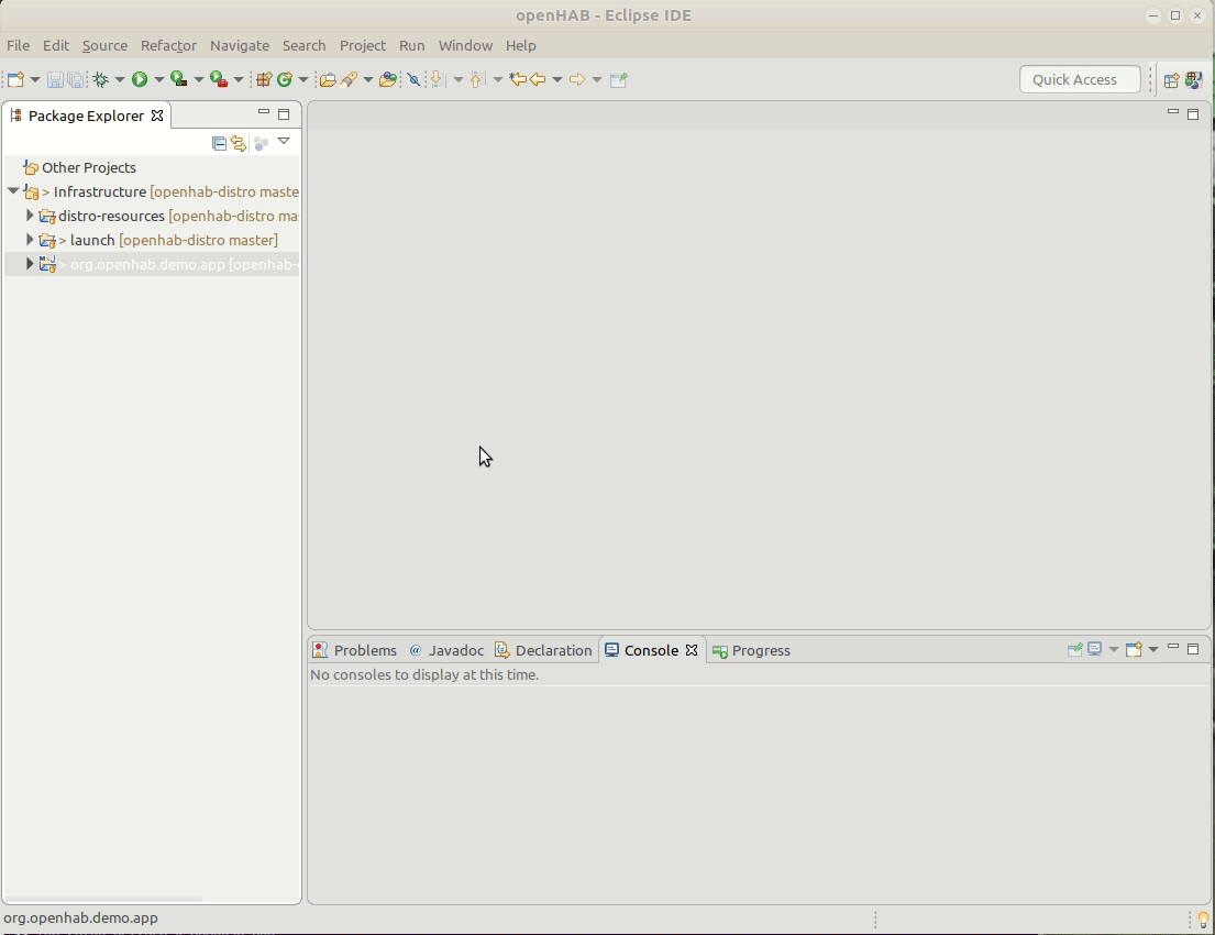

  9. At this point the Eclipse installer is finished and the Eclipse IDE is automatically launched to continue the installation process.
    Attention
    It is important, during the first Eclipse IDE launch, to leave Eclipse open until all openHAB related initial Setup tasks / Download sources / Builds are completed.
    Setup tasks will personalize the IDE with openHAB code formatting tools, configurations and a demo app. Setup tasks will also download openHAB latest projects you have selected during installation. Like openhab-distro and the add-ons openhab-addons project if you have selected it.

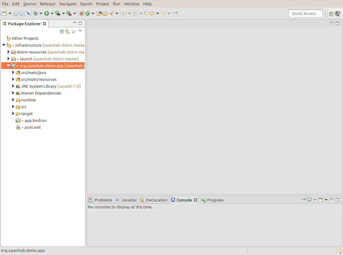

Under Infrastructure you will find the project org.openhab.demo.app. This project contains the full configuration to run openHAB. The following files are of interest for the execution environment:
|- org.openhab.demo.app
|--- runtime
|------- conf             Here you configure the manual text files
|------- userdata         Here is the openHAB user data
|------- log4j2.xml       XML file for logging options
|--- app.bndrun           The file to start openHAB
|--- pom.xml              The pom file with all dependencies for the demo project

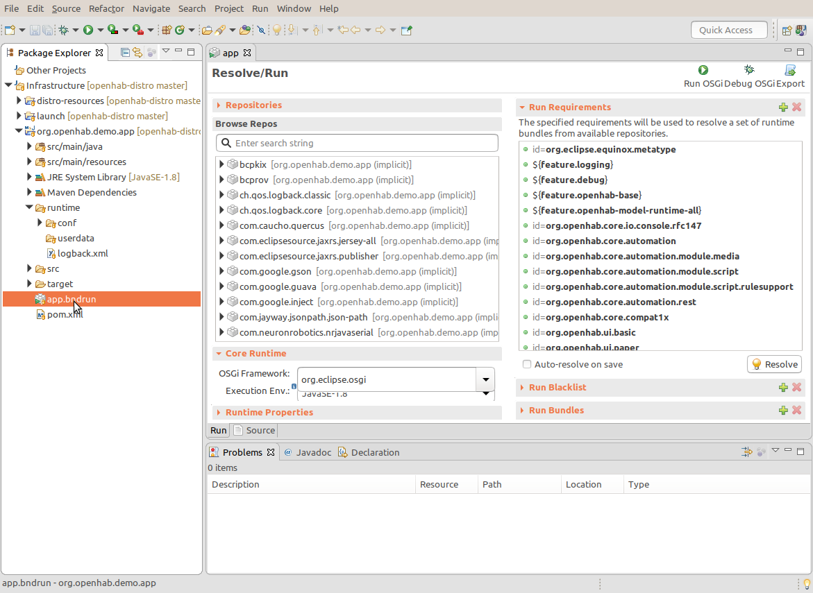

  2. To run the add-on with the app.bndrun run configuration. Double click to open app.bndrun file (takes a few seconds):
    Bndtools

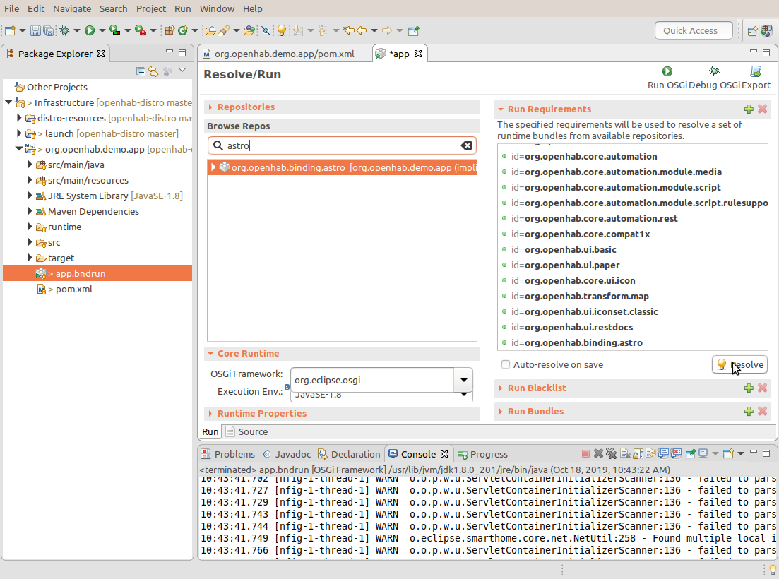

  3. Under Browse Repos search for the add-on you want to run (astro in our case) and add it to the Run Requirements list using drag&drop from the Browse Repos list:
    TIP
    If you cannot find the binding you want run/debug in the Browse Repos list, or the list is empty, then it is likely either the pom.xml of the demo project contains an error or there is a build problem with your project. Check if your project has no compile errors. Or run Maven on the command line to check if it reports any errors.
    app.bndrun
  4. Save and click "Resolve": a window with the list of resolved bundles will be shown. Click Finish and save the file.
    TIP
    Watch out - it's easy to miss saving the app.bndrun file. If you see the little asterisk next to app in the app tab you haven't yet saved.
