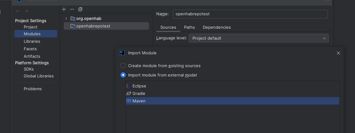

  1. Open IntelliJ, select the file/open, and choose the <PARENT_DIR>
  2. Open The Module settings (inside Project Settings, or use F4). Click on the + button and select Import module.
  3. Choose one of the repository directory you just cloned. select the Maven external model as import format. IntelliJ will start importing and indexing. It will take while, wait until finished. The Module window should now be filled with a bunch of projects. Import modules

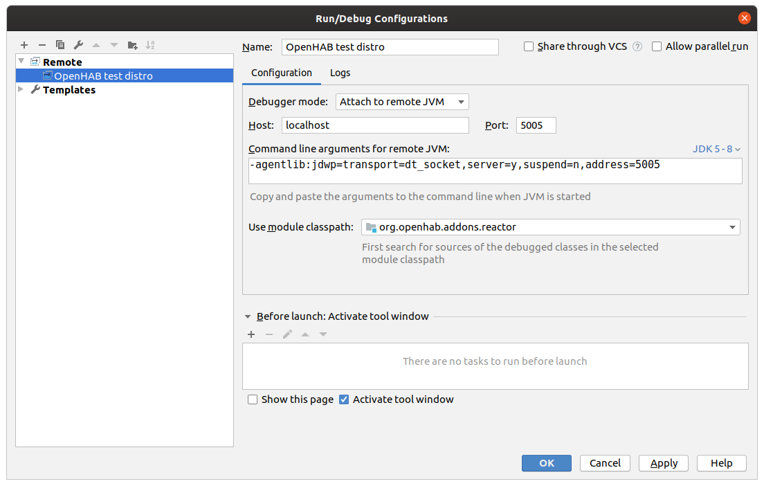

  3. Create a Remote Debug runtime configuration in IntelliJ:
    • open menu Run | Edit configurations
    • click the + sign to add a "Remote" configuration
    • adapt the module setting to the root (org.openhab.addons.reactor)
    • click OK
    • start the debug configuration
    • the IntelliJ console should log: Connected to the target VM, address: 'localhost:5005', transport: 'socket'
Remote Debug Run Configuration
You can now add breakpoints to your project now and your test distro should stop there.

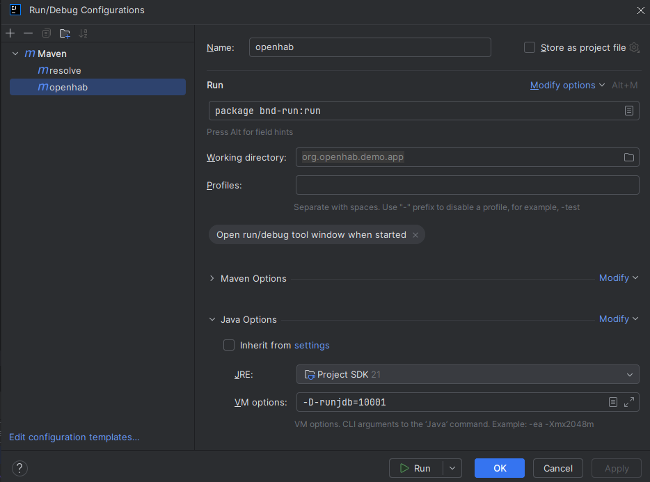

After this, instead of using the command line, you can setup IntelliJ to launch the maven tasks.
Launch Maven Task

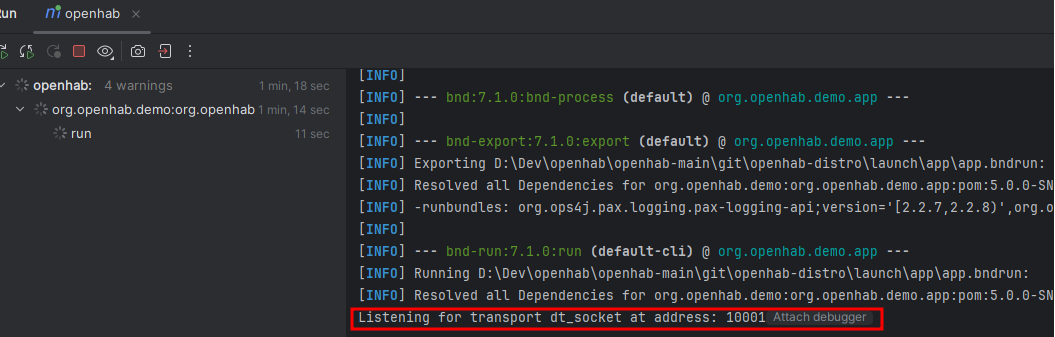

When launching the demo project from IntelliJ with the bnd debug option (in VM options in the screenshot above), look in the Run window for the mention "Listening for transport". You can then click on the Attach debugger to automatically start a debugging session.
Attach debugger
