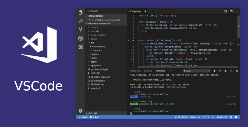

Visual Studio Code

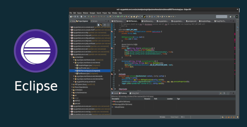

Eclipse IDE

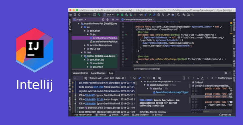

IntelliJ IDE

Not sure what to choose?: openHAB maintainers use Eclipse IDE (opens new window).
