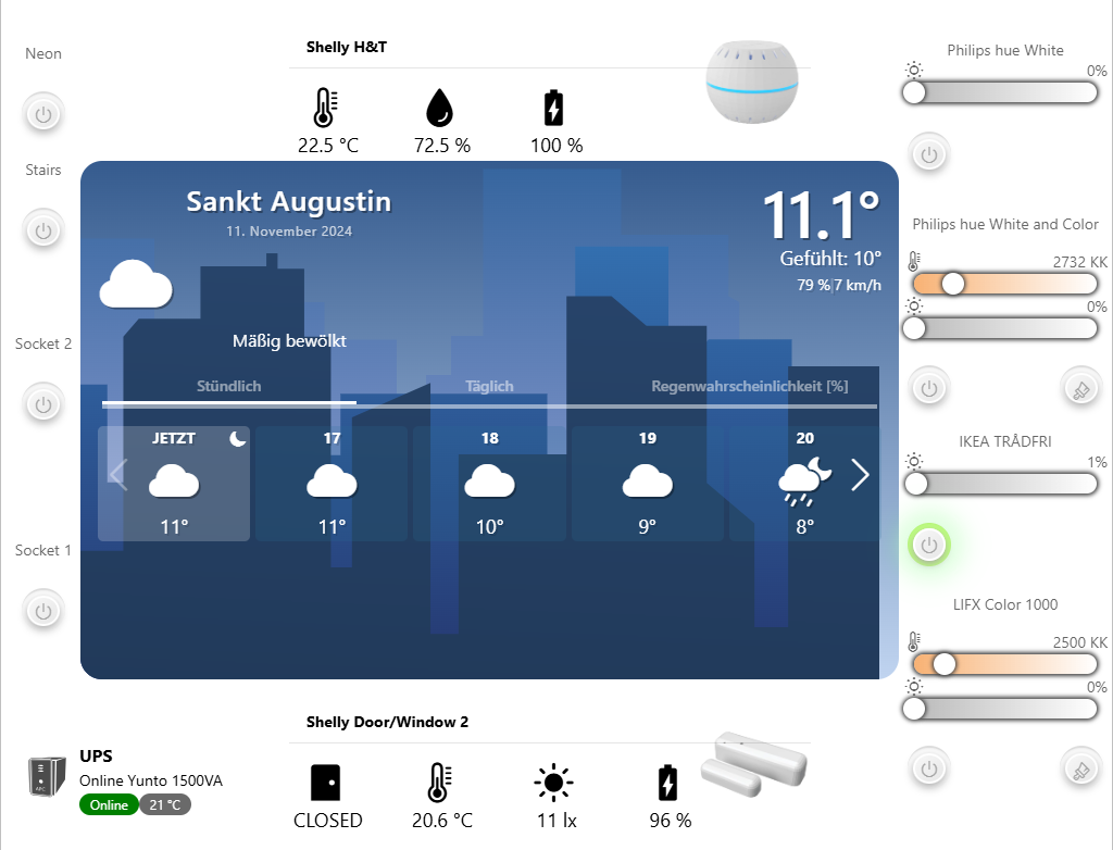

# Fixed Layouts
Fixed layouts allow you to position and size widgets freely, either on a grid with Fixed Grid layout, or in a completely free way with Fixed Canvas layouts (with Fixed Canvas, you are still able to temporarily switch on a grid if you want to snap some widgets).
The main idea is to create a layout on which you can freely place widgets which provide the interaction with your home automation system.
You can even make the background image interactive and use it as multi-widget to control and trigger actions like you can do with widgets.

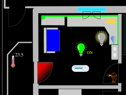

The below image depicts a few examples that can be achieved with interactive backgrounds which are completely done without using widgets.
  • The sofa can be directly clicked to control something that is related to the sofa.
  • The green bar around the desk is not only a clickable LED-Strip but also reflects the color that is currently selected.
  • The light bulb in the middle is filled by the color that is configured for the State ON of the light.
  • The light at the right is using a "glow" effect to indicate that it is currently switched on. This glow effect is modelled in the SVG and is just enabled disabled by the item state.
  • The door is depicted with red gradient designed in the SVG and the gradient is shown when the door is open (the same would happen for the windows on the top).
  • The astronaut with the megaphone has an animation that fades in and out when the state is ON.
  • The horizontal button below the green light is an animated button completely modelled in the SVG and controlled by openHAB.

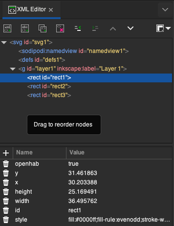

You can see several elements that represent the rectangles we have drawn. To make the SVG interactive, you need to add a special attribute to the elements you want to be clickable and therefore interactive. This attribute is called openhab and can be set to any value, but it is recommended to use a meaningful value like "true".
Let's add this attribute to the first rectangle either via Inkscape or directly within the file, then save the image and reload the page:
  <rect style="fill:#0000ff;fill-rule:evenodd;stroke-width:0.264583"
    id="rect1"
    width="36.495762"
    height="25.169491"
    x="30.203388"
    y="31.461863"
    openhab="true" />
Note that you have added the openhab="true" attribute to the first <rect>angle and not to a group <g> (which we talk about below)

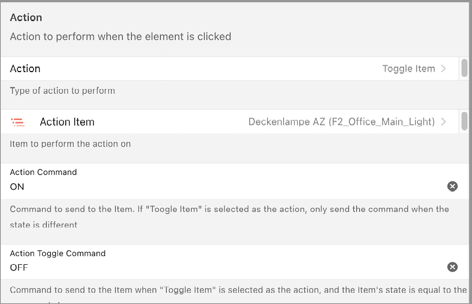

  • Click on it and a dialog, which is similar to configurations of a normal widget except that it has some additional settings, will appear.
  • Later, after configuration, you can go to Run-Mode and try out your configuration.
# Configuration of an interactive element
The dialog has many options that allow you to configure the interactive element. Usually you will first configure the Action and the Action Item like in a normal widget.

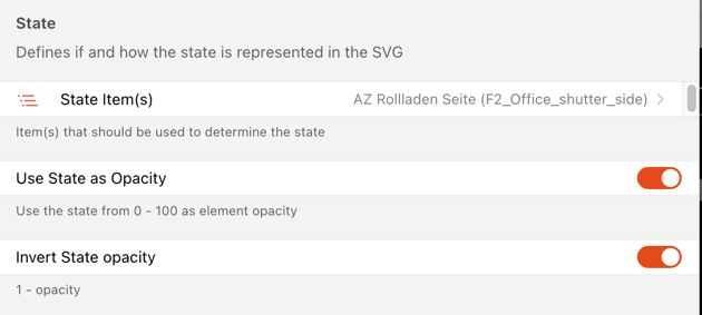

  • Use State as Opacity: If this option is enabled, the state of the item will be used to set the opacity of the element. This is in particular helpful if the element should become more transparent depending on State Percentage or ON/FF of an item.
  • Invert State Opacity: If this option is enabled, the opacity will be inverted.
An example could be the closing state of a rollershutter that makes a window element more and more (in)transparent. The blue bar that depicts the window will become less and less transperent the more the roller shutter is closed and will finally look like the wall when the rollershutter is completely closed.
The following configuration uses the inversion of the percentage state value as 100 should become 0 and vice versa.
  • Minimum Opacity applied: If you want the minimum not to be 0, you can set it which makes sure the element will not be completely hidden but still be partially visible. An example could be to show the presence/absence of people like shown below where the minimum has been set to 0.2. In this case the opacity is derived from the ON/OFF state of the openHAB presence item state where 1 equals 100% and 0 equals 20% instead of 0%.
