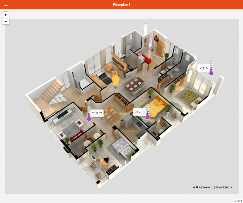

Floorplan Pages can display markers or other elements over a custom image of your choice that you can zoom & pan.
Floorplan Example

In the Design view, configure the properties below Background Configuration.
Images should be stored in /conf/html/[your directory]/
Image URL: /static/[your directory]/[your image file]
e.g:
/static/floorplan/FloorPlan3Dsmall.jpg
Image Width and Image Height: Enter the actual sizes of your image
To add markers, you can do it either:
  • in Design mode under Markers: click Add marker, then click on the newly added entry to configure the marker. Using the black context menu, you can reorder or remove existing markers.
  • in Run mode: click Add marker and drag the new marker to the desired position. While it's "selected", a popover toolbar will appear, allowing you to configure it, edit its YAML, copy it (a Paste button will then appear besides Add Marker), or remove it.
