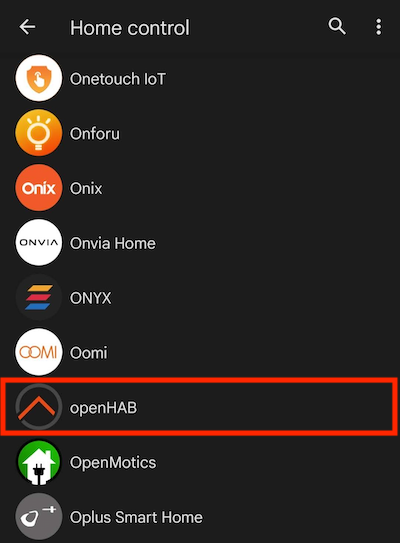

# Setup & Usage of the Google Home App
- Make sure Google Play Services is up to date.
- Visit "Google Home" app entry in Google Play Store on Android.
- Set up the voice-activated speaker or Android phone (version 6+) with your Google account.
- Make sure you're the correct user.

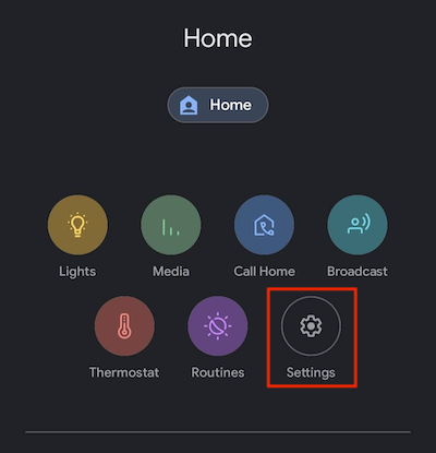

- Start the Google Home app on your phone.
- Go to the settings part:
Home > Settings.

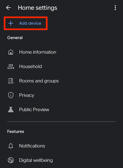

- Press the
+ Add devicebutton in the Settings screen.

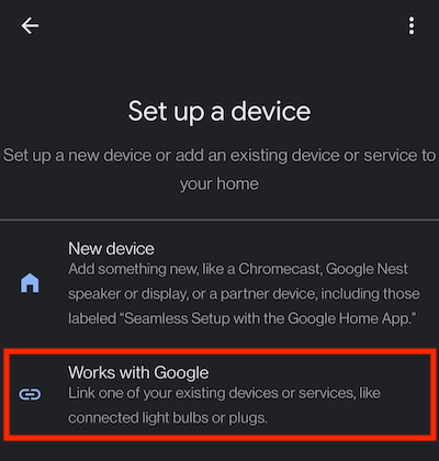

- Choose
Works with Google
- Search and select
openHAB.

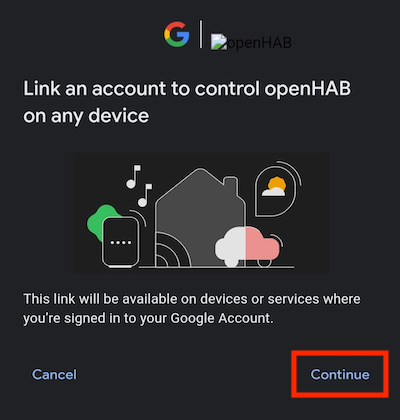

- Continue with linking your account.

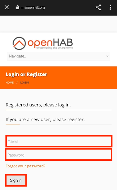

- Login at
myopenhab.orgwith your username and password.

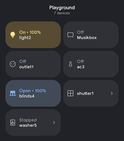

- Make sure to assign your devices to rooms to properly use voice commands.
- You can now control your devices from the Google Assistant and Google Home.
