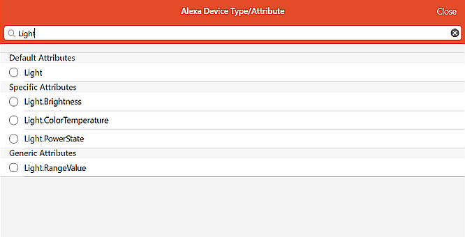

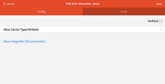

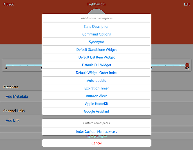

Single items in openHAB can be mapped to a single endpoint in Alexa through the use of the item metadata (opens new window).
A simple example of this is a light switch. In openHAB a light switch is defined as a "Switch" item and responds to ON or OFF commands.
Switch LightSwitch "Light Switch" {alexa="Light"}
Setting this on a single item will create an Alexa endpoint as a lighting device with the spoken addressable name "Light Switch" and power control capability. You can ask Alexa, turn on Light Switch.

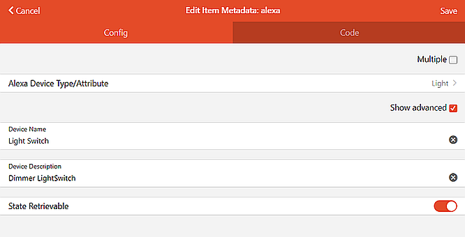

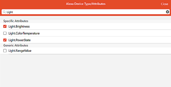

In openHAB, a "Dimmer" item responds to both brightness and on/off commands. Using the same metadata device on that item will give power and brightness control to the Alexa endpoint. Alternatively, the device name can be defined in the metadata parameters, instead of the item label, along with a customized description that will show in the Alexa app. You can ask Alexa, turn on Light Switch as well as Alexa, set Light Switch to 50%.
Dimmer LightSwitch {alexa="Light" [name="Light Switch", description="Super Smart Light"]}

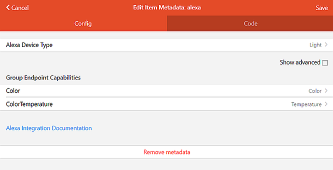

The same for a "Color" item responding to color, brightness and on/off commands. If you need to limit the default capabilities, you can specify in the item configuration each device attribute your device supports, prefixed with the Light device type. The example below shows a colored light switch with color and power on/off controls only. The brightness control would be omitted.
Color LightSwitch "Light Switch" {alexa="Light.Color,Light.PowerState"}

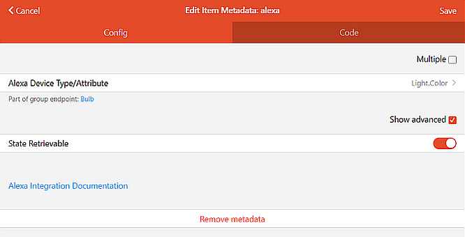

A smart bulb with shade of colors controls.
Group Bulb "Bulb" {alexa="Light"}
Color Color "Color" (Bulb) {alexa="PowerState,Brightness,Color"}
Dimmer Temperature "Temperature" (Bulb) {alexa="ColorTemperature"}
A smart bulb with shade of white controls.
Dimmer White "White" (Bulb) {alexa="PowerState,Brightness"}

# UI Configuration
To add the metadata settings to an item in MainUI, click on Settings and then Items from the sidebar logged in as an administrator, and select the item to configure from the list. Click on Add Metadata and select the Amazon Alexa namespace.
Click on Alexa Device Type/Attribute.
Select the attribute to configure the item as.
To select multiple attributes, click the Multiple checkbox in the top right corner of the metadata configuration page.
Once the attribute(s) are selected, configure the associated metadata parameters if necessary. Some parameters may only be visible when the Show Advanced checkbox is enabled. When finished, click Save located in the top right corner to save the metadata settings.
For group items, click on Alexa Device Type instead and select the device type. Each group member with Alexa metadata settings will show under the Group Endpoint Capabilities section. Any invalid capability part of the group will show as ignored.
Click on any of the active group capabilities to access the associated item metadata settings directly. Each of them will display the group endpoint(s) they are part of, and their attribute selection menu will be filtered based on the group supported and already configured capabilities.
