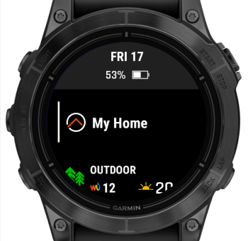

This app is built on the foundation of openHAB sitemaps, which define an interactive view of your openHAB model. A sitemap allows you to specify which devices are accessible through the app and how they are organized and presented.
The app consists of two components: the Glance and the Widget. The Glance displays the name of the sitemap and acts as the entry point into the full-screen Widget, which shows the sitemap's content.
Once opened, the Widget polls the sitemap at a configurable interval to fetch updates. Commands are sent to openHAB via its JSON-based REST API. If your openHAB setup does not support this API, you can alternatively configure a custom Webhook.
Inside the Widget, sitemap elements are displayed as Sitemap Widgets.

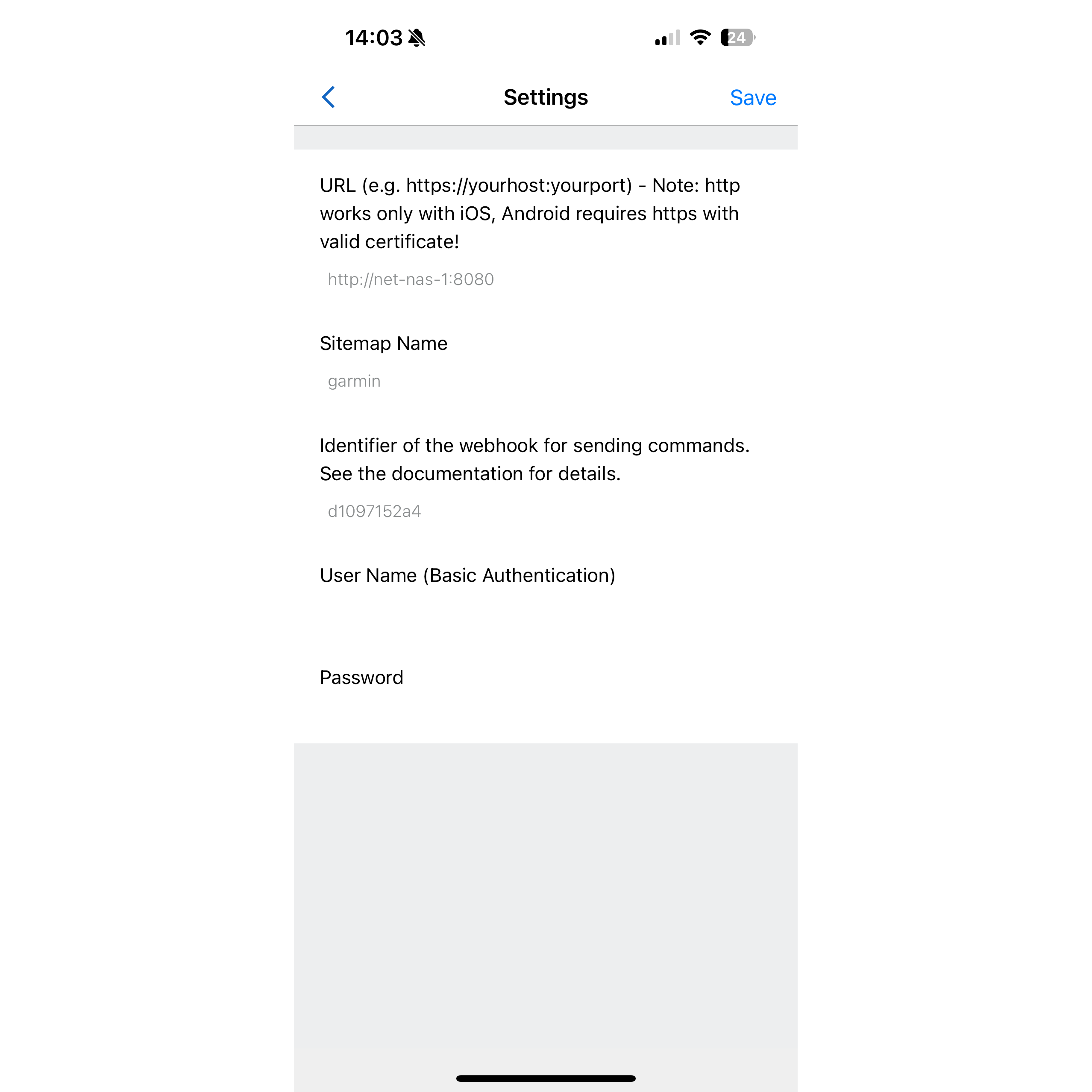

Once the app is installed, you can configure the following settings by opening it in the Garmin Connect IQ smartphone app.
Setting Description
URL Your openHAB URL in the format https://host:port or http://host:port. Note: HTTP only works with iOS. See Connectivity and Using myopenHAB for details.
Sitemap Name Name of the sitemap to display. See Sitemap Setup for details.
Native REST API Support Enable if your openHAB supports the new JSON-based REST API for sending commands. See Sending Commands for details.
Webhook Identifier If your openHAB version doesn't support the JSON-based REST API (see above), you can configure a custom webhook to send commands. See Sending Commands for details.
Username For basic authentication (used for myopenHAB, see below)
Password Password for basic authentication
Supress empty response errors Suppress errors for empty sitemap responses. Recommended when using myopenhab.org (opens new window), which occasionally returns empty results. See the related openhab-cloud issue #496 (opens new window) for details.
Polling Interval (ms) Interval between data requests to your openHAB instance. Set to 0 to fetch new data immediately after the previous response is processed. Polling only occurs while the app is open, not in the background. If you're using myopenhab.org (opens new window), it's recommended to use the default (3000 ms) or a higher value to avoid overloading their servers. If you're connecting to your own openHAB server directly, you may try setting it to 0 for more responsive updates.

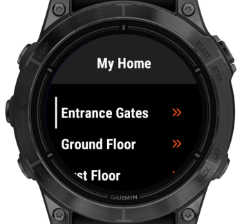

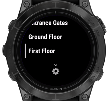

Here is an example of a sitemap containing three Frame elements.
sitemap garmin_demo label="My Home" {
 Frame label="Entrance Gates" {
  Switch item=EntranceGatesTrigger label="Open/Close" mappings=[OFF="", ON="OK"]
  Text item=EntranceGateStatus label="Status"
 Frame label="Ground Floor" {
 Frame label="First Floor" {

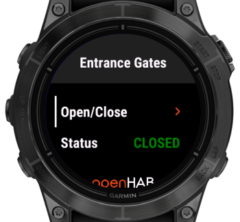

This configuration produces the following display in the UI:

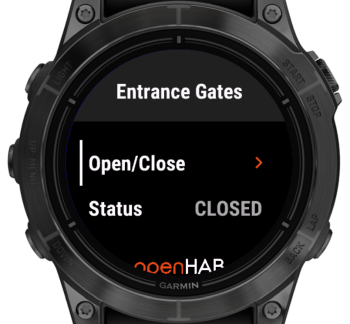

In this example, the Text Sitemap Widget is used to display the status of entrance gates. Triggering the gates is handled by a separate Switch element.
  Switch item=EntranceGatesTrigger label="Open/Close" mappings=[OFF="GO", ON="DONE"]
Resulting UI:

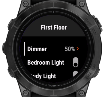

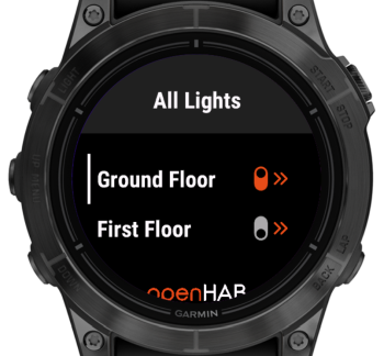

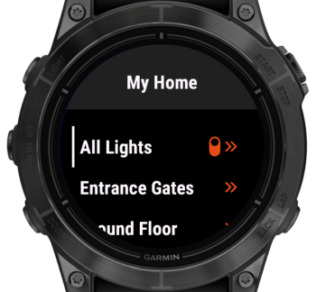

# Group
The ➡️ Group Sitemap Widget will present a submenu containing all the items in the associated item of type Group. This also works recursively, if the Group item itself contains other Group items, those will again open their own submenus.
Example configuration:
In this example, the CC_House_Lights item represents a hierarchical structure: it contains groups for each floor (e.g., the first floor), which in turn contain groups for individual rooms, and those room groups include the actual light switch items.
 Group item=CC_House_Lights label="All Lights"
Resulting UI:

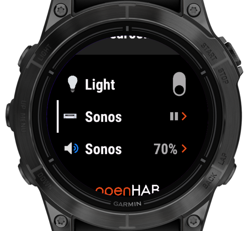

# Switch and Selection
The ➡️ Switch and ➡️ Selection widgets display the current state of an item and allows the user to send commands to change it.
In other UIs, the Switch and Selection widgets behave differently:
  • Switch presents all available options inline within the page.
  • Selection opens a dedicated selection dialog to choose a value.
However, due to the limited screen space on wearables, the Garmin app always opens a dedicated action menu whenever there are more than one or two options.
As a result, Selection is treated as a synonym for Switch, and both behave identically in the Garmin app.

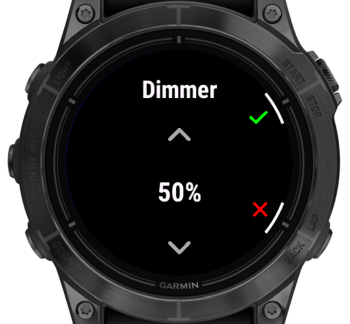

  1. Toggle Switch – for binary items (ON/OFF) and Dimmer items.
  2. Rollershutter Control – a full-screen view for Rollershutter items with UP, DOWN, and STOP buttons.
  3. Player Control – a full-screen view for Player items with PLAY/PAUSE, NEXT, and PREVIOUS buttons.
  4. Generic Switch – for items with custom or multiple commands, defined via mappings or item metadata.
# Toggle Switch
This is the default behavior when:
  • No mappings are provided,
  • The item has no command descriptions,
  • The item is not of type Rollershutter.
The switch simply toggles between ON and OFF.

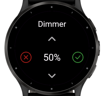

Note: If an item of type Dimmer is linked to a Switch and no state mappings are defined, a toggle switch will be displayed. The toggle will send ON and OFF commands. For display purposes, a Dimmer state of 0 is treated as OFF, while any value from 1 to 100 is considered ON.

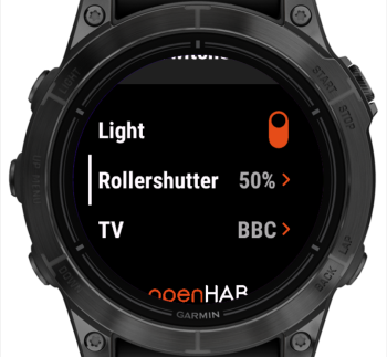

Frame label="Switches" {
    Switch item=Light label="Light"
UI Preview:

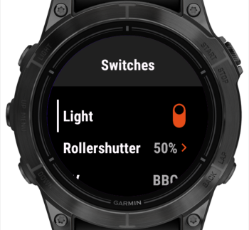

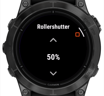

# Rollershutter
When the item type is Rollershutter, the widget opens a full-screen control with UP, DOWN, and STOP actions.
In the menu, the item displays a textual or percentage-based state:
  • mappings can be used to map numeric states (e.g., 0="Open", 100="Closed"), but only affect the menu label.
  • The full-screen view always shows numeric percentages for clarity, since states like 0 and 100 can reflect transitional movement (e.g., “opening”) rather than final state (“open”).
Example:
    Switch item=Rollershutter label="Rollershutter" mappings=[0="Open", 100="Closed"]
UI Preview:

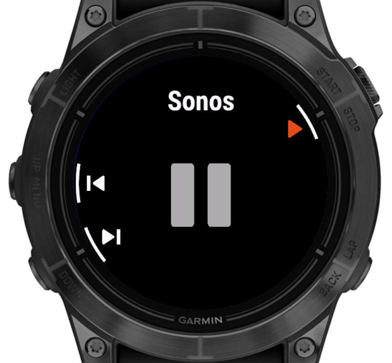

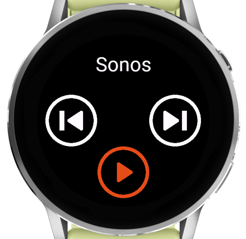

# Player
When the item type is Player, the widget opens a full-screen control with PLAY/PAUSE, NEXT, and PREVIOUS actions. In the menu, the item displays the PLAY/PAUSE state.
Example:
    Switch item=MediaControl label="Audio"
UI Preview:

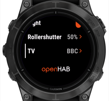

# Generic Switch
This variant is used for items that don’t fall under the previous two cases.
It supports multiple custom commands, defined either via:
  • mappings in the sitemap,
  • or command/state descriptions on the item (e.g., from a channel or metadata).
In the menu, the widget displays the current state as text:
  • If the state matches one of the mapped commands, the corresponding label is shown.
  • Otherwise, the raw state is displayed.
Tip: You can use an empty label in mappings if the item's function is self-explanatory from context.
Selection behavior:
  • If one command is defined, it is sent immediately when the item is selected.
