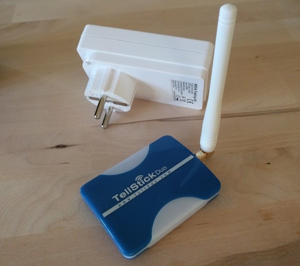

# Tellstick Binding
This is an openHAB binding for Tellstick devices produced by Telldus, a Swedish company based in Lund.
The original Tellstick focused on controlling 433 MHz devices like switches, dimmers and reading sensors from different brands. Many of the supported devices are cheaper and "low-end" and support have been made by reverse engineer the transmission protocols. All of these 433 MHz devices is one-way, so some versions of the Tellstick monitoring the air to keep the state of all devices.
The latest versions have also implemented Z-Wave as transmission protocol which open up for more robust transmission due two-ways communication.

# Telldus Core Bridge
To enable communication between openHAB and tellstick-core service (Telldus center) they must use same architecture, eg. 32-bit or 64-bit. The supplied version from Telldus is compiled against 32-bit architecture. Therefore, it is better to use 32-bit java for openHAB. To check which version of Java is currently in use, run:
java -d32 -versionFor changing architecture in Linux check out:
dpkg --add-architecture
The telldus-core bridge uses a library on the local computer which is a .dll file for Windows and a .so file for Linux. The default one is usually correct.
Bridge tellstick:telldus-core:1 "Tellstick Duo" [resendInterval=200,libraryPath="C:/Program Files/Telldus/;C:/Program Files (x86)/Telldus/"]
Optional:
- libraryPath: The path to tellduscore.dll/so semicolon seperated list of folders.
- resendInterval: The interval between each transmission of command in ms, default 100ms.
