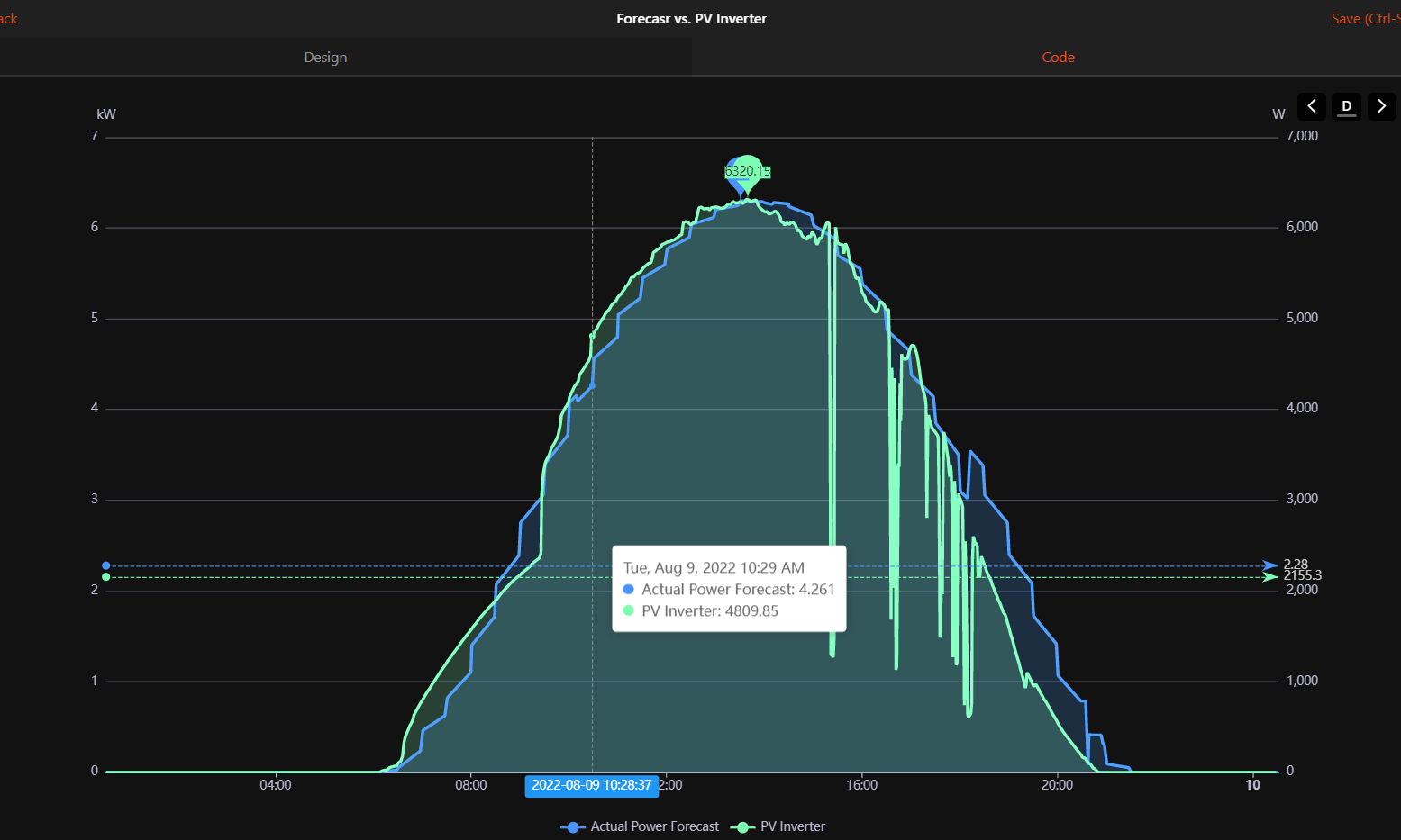

Display Power values of Forecast and PV Inverter items

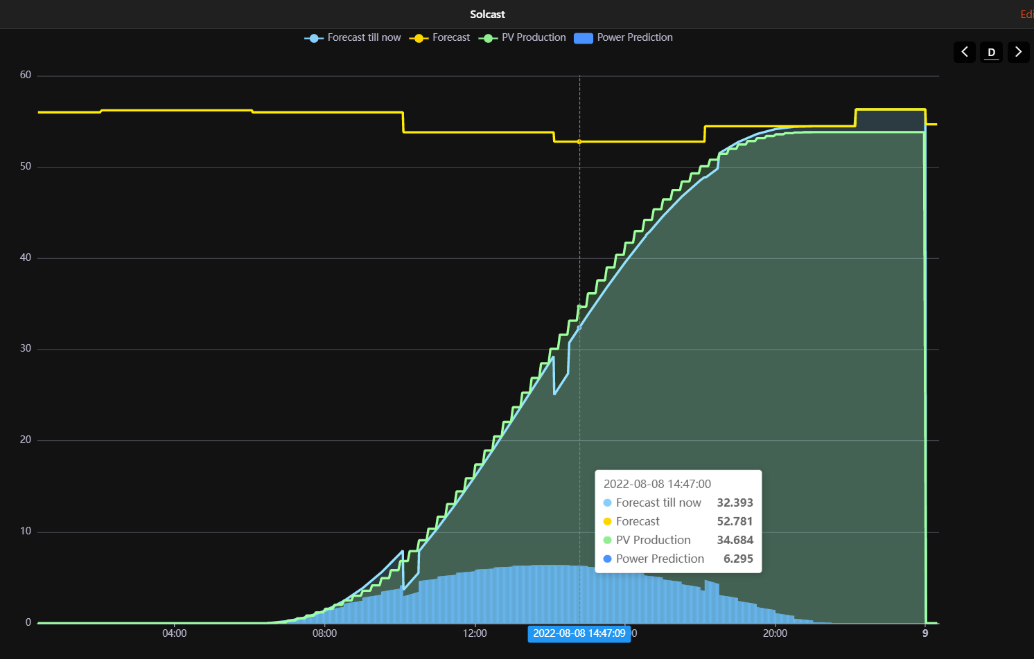

Display Energy values of Forecast and PV inverter items Yellow line shows Daily Total Forecast.

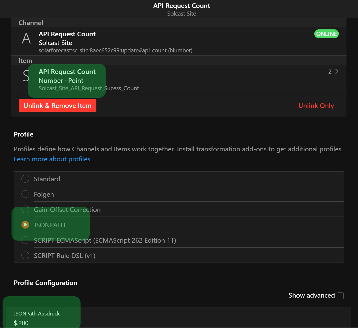

The api-count channel delivers a JSON object with 3 different counters:
  • 200 - succesful API calls
  • 429 - unsuccessful API calls due to throttling, too many calls
  • other - unsuccesful API calls due to other problems
{"200":2,"other":0,"429":0}
You can connect a Number item to this channel using a JSONPATH transformation (opens new window) referring the wanted JSON key e.g. $.200.
