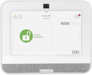

This binding directly controls a Qolsys IQ (opens new window) security panel. This allows for local monitoring of alarm and zone statuses as well as arming, disarming and triggering alarms.
Qolsys (a division of Johnson Controls) is a popular manufacturer of alarm systems. The Qolsys IQ line of panels supports both wireless and hard wire sensors and features built in Cellular and Wi-Fi dual path communication that natively integrates with Alarm.com (opens new window) monitoring and supervision.
This binding directly interfaces with the panel and does not require cloud access.
Qolsys IQ 4
