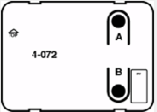

# 2 buttons switch
Nikobus Switch with 2 buttons
 1 = A
 2 = B

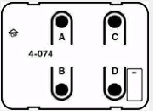

# 4 buttons switch
Nikobus Switch with 4 buttons
maps as
 3  1
 4  2
so
1 = C
2 = D
3 = A
4 = B

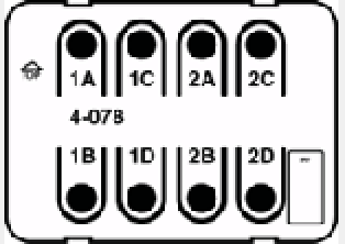

# 8 buttons switch
Nikobus Switch with 8 buttons
maps as
 7  5  3  1
 8  6  4  2
so
1 = 2C
2 = 2D
3 = 2A
4 = 2B
5 = 1C
6 = 1D
7 = 1A
8 = 1B
Above example 14E7F4:3 would give:
  • for 4 buttons switch - push button A,
  • for 8 buttons switch - push button 2A.
