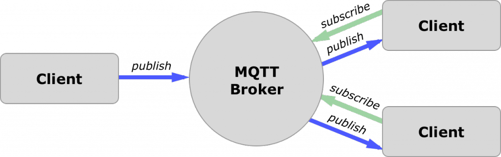

MQTT Architecture
MQTT servers are called brokers and the clients are simply the connected devices.
  • When a device (a client) wants to send data to the broker, we call this operation a “publish”.
  • When a device (a client) wants to receive data from the broker, we call this operation a “subscribe”.
Publish and Subscribe
openHAB itself is not an MQTT Broker and needs to connect to one as a regular client. Therefore you must have configured a Broker Thing first via the MQTT Broker Binding!
