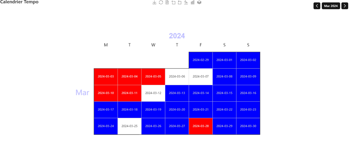

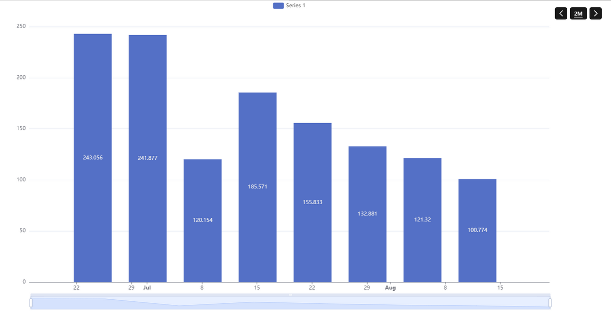

# Displaying Information Graph
Using the timeseries channel, you will be able to easily create a calendar graph to display the Tempo calendar. To do this, you need to enable a timeseries persistence framework. Graph definitions will look like this:
TempoGraph
Sample code :
  future: false
  label: Linky Melody Conso Journalière
  order: "110"
  period: 2W
  sidebar: true
  dataZoom:
    - component: oh-chart-datazoom
        type: inside
  grid:
    - component: oh-chart-grid
        containLabel: true
        includeLabels: true
        show: true
  legend:
    - component: oh-chart-legend
        bottom: 3
        type: scroll
  series:
    - component: oh-time-series
        areaStyle:
          opacity: 0.2
        gridIndex: 0
        item: Linky_Melody_Daily_Conso_Day
        label:
          formatter: =v=>Number.parseFloat(v.data[1]).toFixed(2) + " Kwh"
          position: inside
          show: true
        markLine:
          data:
            - type: average
        markPoint:
          data:
            - name: min
              type: min
            - name: max
              type: max
          label:
            backgroundColor: auto
        noBoundary: true
        noItemState: true
        service: influxdb
        type: bar
        xAxisIndex: 0
        yAxisIndex: 0
  tooltip:
    - component: oh-chart-tooltip
        confine: true
        smartFormatter: true
  xAxis:
    - component: oh-time-axis
        gridIndex: 0
        nameLocation: center
        splitNumber: 10
  yAxis:
    - component: oh-value-axis
        gridIndex: 0
        max: "150"
        min: "0"

# Displaying Tempo Graph
Using the timeseries channel, you will be able to esealy create a calendar graph to show the tempo calendar. You will need for this to enable a timeseries persistence framework. Graph definitions will look like this
The resulting graph will look like this:
TempoGraph
Sample code:
  chartType: month
  future: false
  label: Tempo
  period: M
  sidebar: true
  calendar:
    - component: oh-calendar-axis
        cellSize: 10
        dayLabel:
          firstDay: 1
          fontSize: 16
          margin: 20
        left: center
        monthLabel:
          color: "#c0c0ff"
          fontSize: 30
          margin: 20
        orient: vertical
        top: middle
        yearLabel:
          color: "#c0c0ff"
          fontSize: 30
          margin: 50
  dataZoom:
        orient: horizontal
        show: true
        type: slider
  grid: []
  legend:
        show: false
  series:
    - component: oh-calendar-series
        aggregationFunction: average
        calendarIndex: 0
        coordinateSystem: calendar
        item: Linky_Melody_Tempo
        label:
          formatter: =v=> JSON.stringify(v.data[0]).substring(1,11)
          show: true
          smartFormatter: false
        service: inmemory
        type: heatmap
  title:
    - component: oh-chart-title
        show: true
        text: Calendrier Tempo
  toolbox:
    - component: oh-chart-toolbox
        presetFeatures:
          - saveAsImage
          - restore
          - dataView
          - dataZoom
          - magicType
        show: true
  tooltip:
        formatter: "{c}"
        show: true
  visualMap:
    - component: oh-chart-visualmap
        bottom: 0
        calculable: true
        inRange:
          color:
            - "#0000ff"
            - "#ffffff"
            - "#ff0000"
        left: center
        max: 2
        min: 0
        orient: horizontal
        presetPalette: ""
        show: false
        type: continuous
  xAxis: []
  yAxis: []
