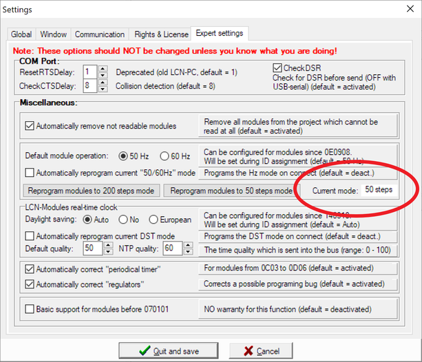

mode Dimmer resolution: native50 or native200 See below. String Yes
timeoutMs Period after which an LCN command is resent, when no acknowledge has been received (in ms) (default: 3500) Integer Yes
ATTENTION: You must set the correct dimmer output resolution in the PCK Gateway Thing (mode)! This setting is crucial, and valid for the whole LCN bus.
It is either 0-50 steps or 0-200 steps. It has to be the same as in the parameterizing software LCN-PRO under Options/Settings/Expert Settings.
When using a wrong dimmer output setting, dimming the outputs will result in unintended behavior!
Please see the following LCN-PRO screenshot to determine the dimmer output resolution for the LCN bus:
LCN-PRO screenshot, showing the 50 or 200 steps for the dimmer outputs

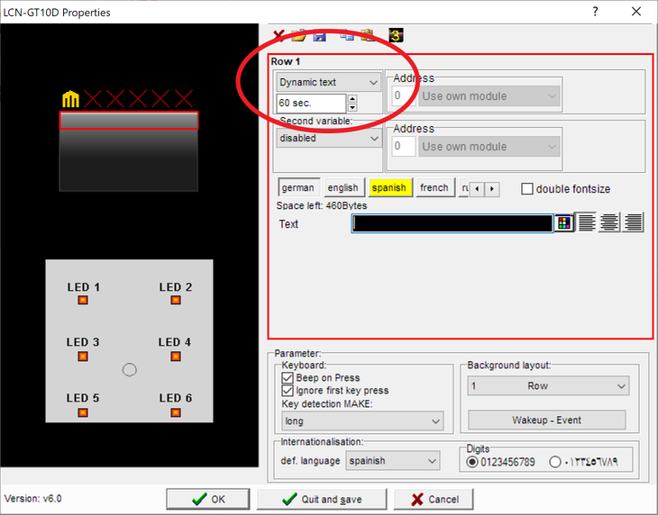

Dynamic Text Dynamischer Text N/A N/A N/A Action: "sendDynamicText": Sends custom text to an LCN-GTxD display.

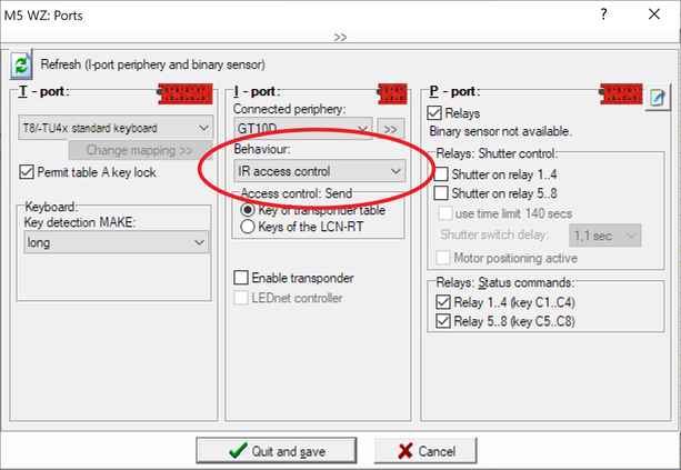

# Transponder/Fingerprints
LCN transponder readers or fingerprint readers can be integrated in openHAB e.g. for access control. The transponder function must be enabled in the module's I-port properties within LCN-PRO.
Example: When the transponder card with the ID "12ABCD" is seen by the reader connected to LCN module "S000M011", the item "M10_Relay7" is switched on:

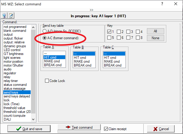

# Command from an LCN Module to openHAB
LCN modules can send commands to openHAB, e.g. by pressing a physical LCN key. The command must be programmed into the LCN module by the programming software LCN-PRO. Only the send keys command (German: "Sende Tasten") is supported.
Program a command to a key of an LCN module via LCN-PRO. When LCN-PRO asks you for the target address, don't select any module, but manually enter the PCK host ID, configured within PCHK (default: 4). Select the send keys command and "A-C (former command)", as PCHK 3.2.2 only supports the old command. Then, select any key(s) you want to send to openHAB. These can be freely chosen, as they are only evaluated by openHAB.
Screenshot, showing the send keys command
The following rule can be used to trigger any action:
rule "Module 12 sent A1 Hit"
    Channel "lcn:module:b827ebfea4bb:S000M012:hostcommand#sendKeys" triggered "A1:HIT"
    M10_Relay7.sendCommand(ON)
A1 is the key of the send keys command, programmed by LCN-PRO. After the colon, the LCN "hit type" follows: HIT, MAKE or BREAK (German: kurz, lang, los)
If multiple keys or key tables are programmed in a single "send keys" command, multiple triggers will be executed.

# Remote Control
To evaluate commands from LCN remote controls (e.g. LCN-RT or LCN-RT16), the module's I-port behavior must be configured as "IR access control" within LCN-PRO:
Screenshot, showing the I-port properties for remote controls
# Remote Control Keys
The trigger Channel lcn:module:<pckThing>:<moduleThing>:code#remotecontrolkey can be used to execute commands, when a specific key on a remote control is pressed:
rule "Remote Control Key 3 on Layer 1 hit"
    Channel "lcn:module:b827ebfea4bb:S000M012:code#remotecontrolkey" triggered "A3:HIT"
A3 is key 3 on the first layer. B1 is key 1 on the second layer etc.. After the colon follows the LCN "hit type" HIT, MAKE or BREAK (German: kurz, lang, los).

# Dimmer Outputs with Ramp and Multiple Outputs
The output profile can be used to control multiple dimmer outputs of the same module simultaneously or control a dimmer output with a ramp (slowly dimming).
The optional ramp parameter must be float or integer. The lowest value is 0.25, which corresponds to 0.25s. The highest value is 486s. When no ramp parameter is specified or no profile is configured, the ramp is 0 (behavior like a switch). The ramp parameter is not available for Color _Item_s.

# Hit Key
This Action virtually hits a key of a key table in an LCN module. Simply spoken, openHAB acts as a push button switch connected to an LCN module.
This Action can be used to execute commands which are not natively supported by this binding. The function can be programmed via the software LCN-PRO onto a key in a module's key table. Then, the programmed key can be "hit" by this Action and the command will be executed.
When programming a "Hit Key" Action, the following parameters need to be set:
table - The module's key table: A, B, C or D
key - The number of the key within the key table: 1-8
action - The key's action: HIT (German: "kurz"), MAKE ("lang") or BREAK ("los")
rule "Hit key C4 hourly"
    Time cron "0 0 * * * ?"
    val actions = getActions("lcn","lcn:module:b827ebfea4bb:S000M010")
    actions.hitKey("C", 4, "HIT")
# Dynamic Text
This Action can be used to send custom texts to an LCN-GTxD display. To make this function work, the row of the display has to be configured to allow dynamic text within LCN-PRO:
Screenshot of LCN-PRO, showing the dynamic text setting of an LCN-GT10D
When programming a "Dynamic Text" Action, the following parameters need to be set:
row - The number of the row in the display: 1-4
text - The text to be displayed (UTF-8)
The length of the text may not exceed 60 bytes of characters. Bear in mind that unicode characters can take more than one byte (e.g. umlauts (äöü) take two bytes).
rule "Send dynamic Text to GT10D hourly"
    val actions = getActions("lcn","lcn:module:b827ebfea4bb:S000M012")
    actions.sendDynamicText(1, "Test 123 CO₂ öäü߀") // row 1
