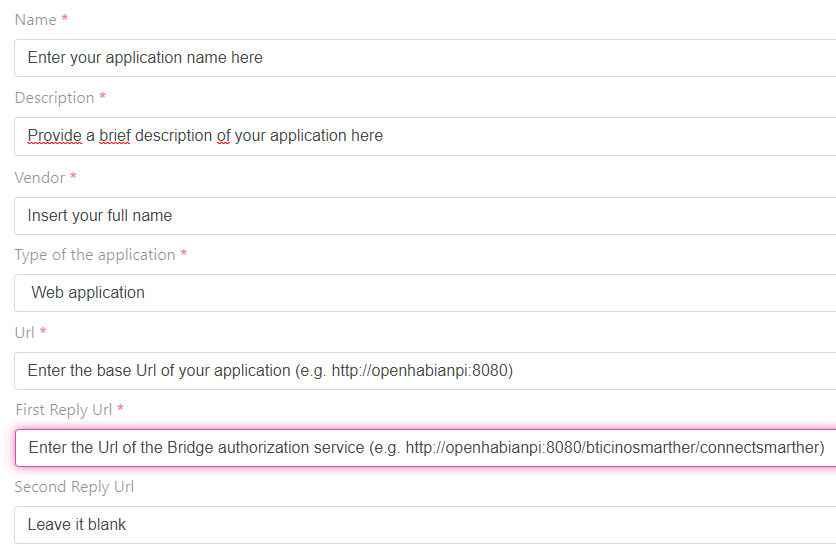

When registering your new Legrand Application for openHAB BTicino Smarther Bridge you have to specify the allowed Reply URL, aka white-listed address. Here you have to specify the URL to the Bridge Authorization page on your server.
For example if you run your openHAB server on http://openhabianpi:8080 you should set http://openhabianpi:8080/bticinosmarther/connectsmarther as the "First Reply URL" required field in Step 1. Other Reply URLs (second, third, etc.) you can leave them blank.
This is very important since the authorize process with Legrand takes place using your client web browser and Legrand will have to know the right URL to your openHAB server for the authorization to be completed. When you have authorized with Legrand, this Redirect URI is where authorization tokens for your openHAB BTicino Smarther Brigde will be sent and they have to be received by the servlet on /bticinosmarther/connectsmarther.

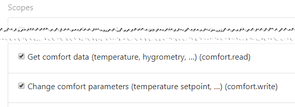

On Step 2, please make sure to select both comfort.read and comfort.write scopes, as they're mandatory for the bridge to manage its chronothermostat devices.

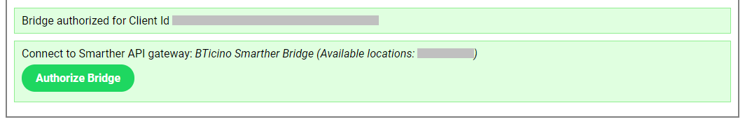

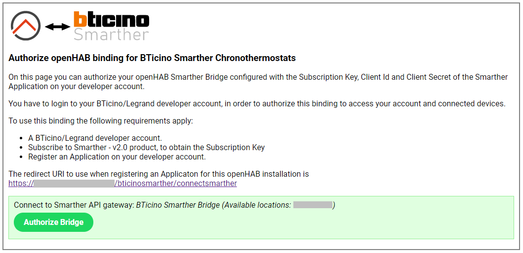

  11. Go to the authorization page of your server (see Application Creation) http://<your openHAB address>:<your openHAB port>/bticinosmarther/connectsmarther; your newly added bridge should be listed there (along with the available locations).

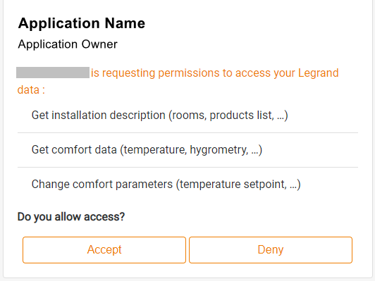

  12. Press the "Authorize Bridge" button; this will take you either to the login page of Legrand portal or directly to the authorization screen.
  13. Login and/or authorize the application; if the Reply URL is correct you will be returned and the entry should show your bridge is authorized with your Client ID; otherwise, go back to your application configuration on Legrand portal and ensure you have set the right Reply URL (see Troubleshooting below).
  14. The bridge will be updated with a refresh token and go ONLINE (the refresh token is used to re-authorize the bridge with Legrand Smarther API whenever required).
