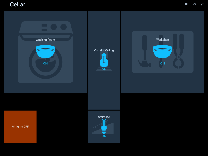

It notably features an embedded dashboard designer allowing to build interfaces easily right on the target device.

  • Add your first widget: select the "Add Widget" menu and choose a widget type (let's say Dummy - a simple widget displaying an item's state)
  • Move the widget by drag-and-drop and resize it with the white chevron - it appears when you click on the widget
  • Hit on the three dots in the widget top-right corner to bring up its context menu and choose "Edit..."
  • Adjust some settings (name, openHAB item etc.) and confirm your changes
  • Save your configuration by clicking/tapping the Save button
  • Click/tap Run to see your dashboard in action - use your browser's back button or the arrow to go back to the drawing board
