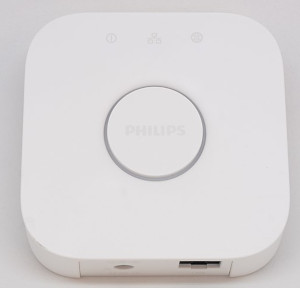

As soon as the service is enabled, it will announce the presence of an (emulated) HUE bridge of the second generation (square bridge). Hue bridges are using the Universal Plug and Play (UPnP) protocol for discovery.
Philips Hue Bridge
Like the real HUE bridge the service must be put into pairing mode before other applications can access it. By default the pairing mode disables itself after 1 minute (can be configured).
